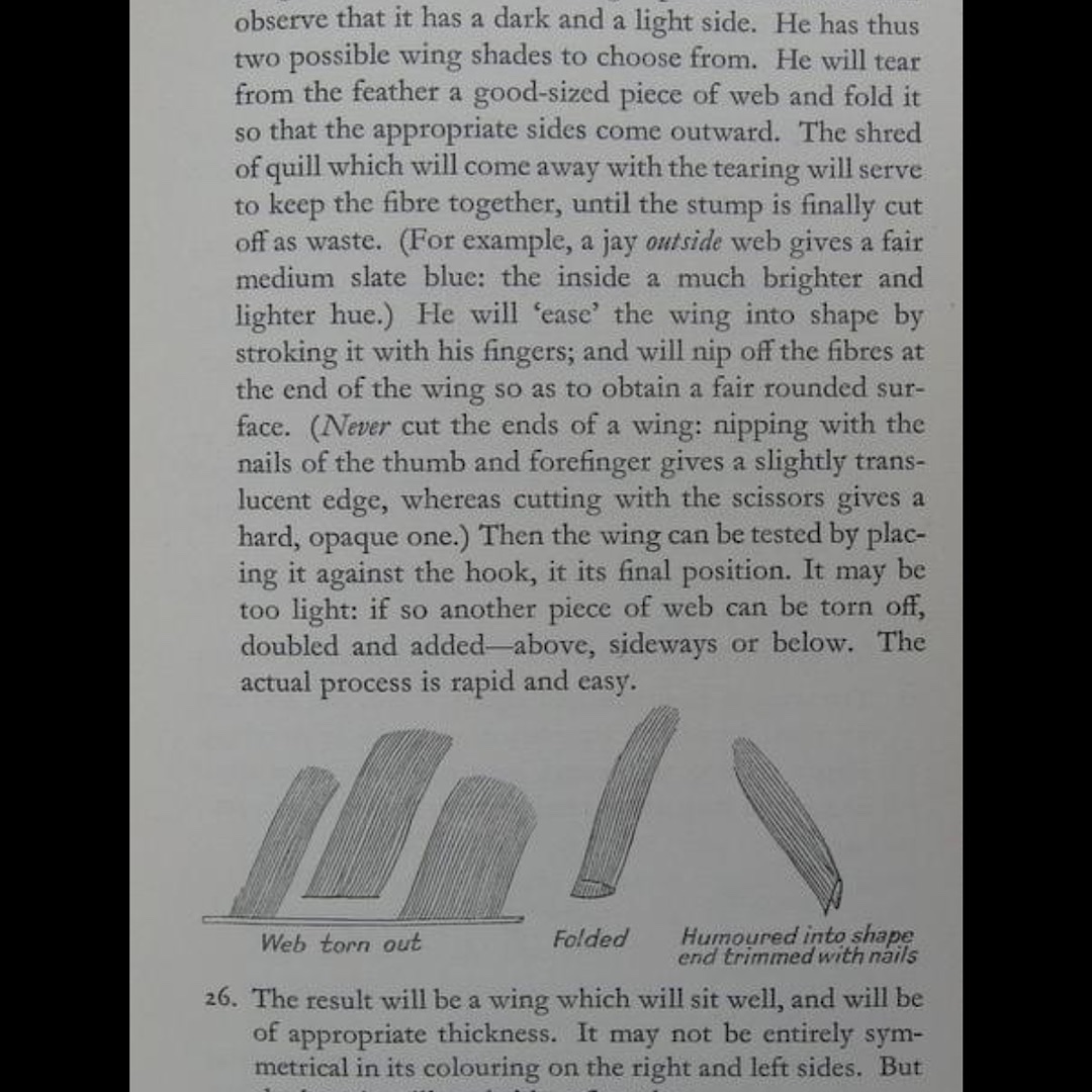

I use rolled or folded wings almost exclusively on my winged wet flies because slip wings just don't hold up unless they're glued. Take a look at the post by wsbailey. That pretty much sums it up. Cut a slip and fold it once, then finesse the fibers into shape like you would for a married wing. For a rolled wing, do the same thing, but fold it twice, then roll it between thumb and fingers.
Things get a bit complicated when your posting the wings upright, as in some of the Clyde style flies. I admit to using a bit of cellire on my fingers to shape the wings and make them more durable.
