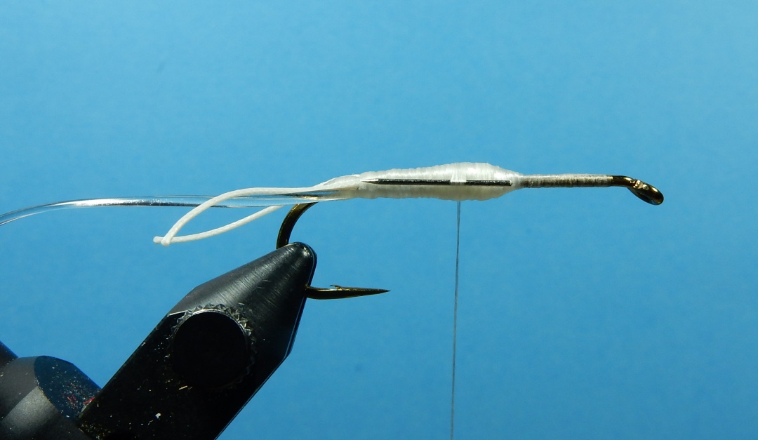

Tie on thread and wrap to the bend. Wrap a bump of thread to help separate the tails.
Tie in the tails and the v-rib and begin to build a tapered body. I'm using v-rib for this fly but if you choose a liquid or larva lace, you may fill the tubing with oil, water etc.
Attach a dressmakers or map pin to the side of the body to determine its length.
The point of the pin should be at the forward end of the thread bump.
The pin should be cut to length from the forward end of the thread bump to the forward end of the tapered body.
Cut both pins to the same length and tie on to the body. Ensure the pins are tied on parallel to the hook shank. The purpose of the pins is to create a horizontal taper to the under body.
Wrap the tying thread to fully cover the pins.

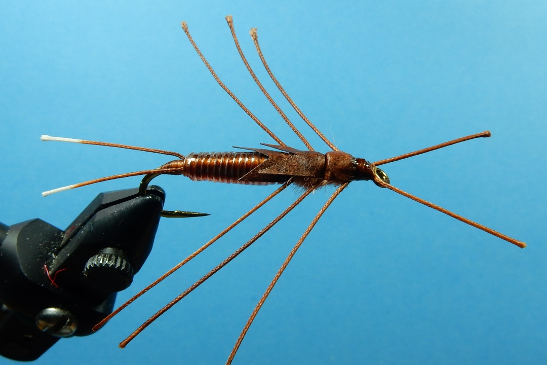

Using the lighter, heat up the bodkin (not to cherry red) and while hot, gently press the bodkin against one of the legs to bend the leg approximately 90 degrees. This will melt the fly line fibers of the fly line backing in contact with the heated bodkin just enough to keep it bent. Repeat on the other side.
CAUTION: A too hot bodkin will cut right through the fly line leg like butter!
Repeat the process with the remaining legs.
After all of the legs have been bent to shape, trim the ends as shown above. Trim the tails and antenna.
This is the top side of the fly.
This is the bottom side of the fly.
