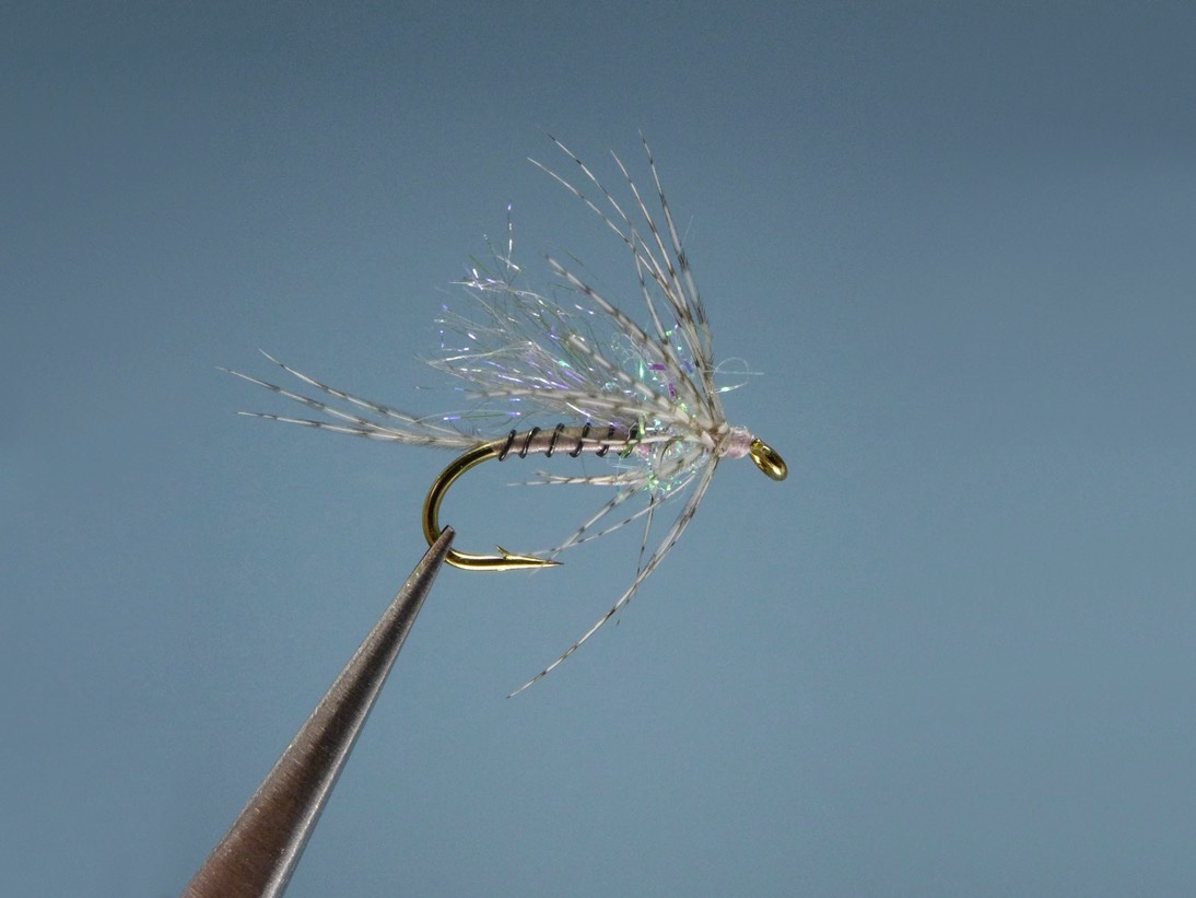

Gray Jupiter Mayfly
Hook: #12-#16 Mustad R30 (Light) or Mustad S82 Nymph (Heavy, shown) Depending on Desired Sink Rate
Thread: 12/0 Benecchi Light Dun
Abdomen: Danville Gray Rayon Floss
Ribbing: UTC Ultra Wire Black Small
Thorax: Hend’s #11 Gray Spectra Dubbing
Wing: Hareline Gray UV Ice Dub
Tail and Hackle: Gray Partridge

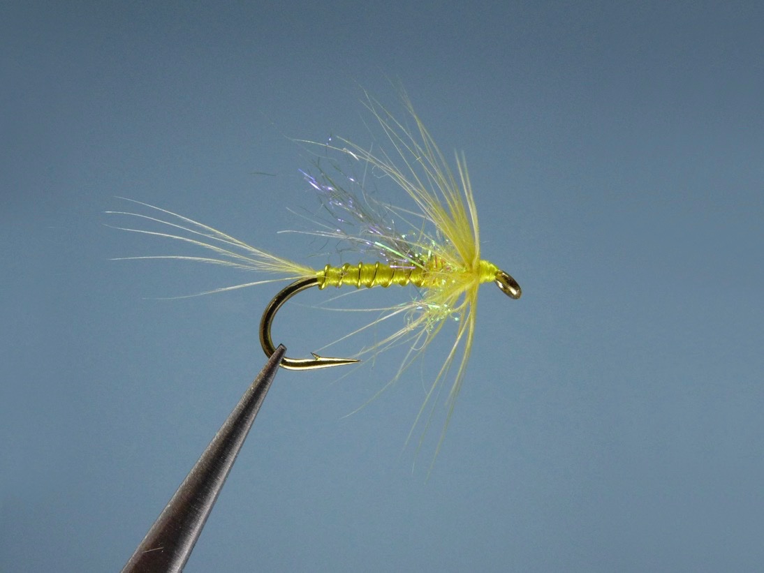

Yellow Jupiter Mayfly
Hook: #12-#16 Mustad S82 Nymph (shown) or R30 Dry. Depending on Sink Rate Desired
Thread: 6/0 Danville Flymaster Yellow
Abdomen: Danville Yellow Rayon Floss
Ribbing: UTC Ultra Wire Hot Yellow Small
Thorax: Hend’s #6 Golden Yellow Spectra Dubbing
Tail and Hackle: Yellow Hen Cape

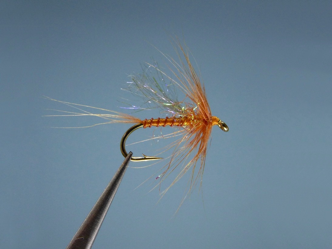

Orange Jupiter Mayfly
Hook: #12-#16 Mustad S82 Wet or Mustad R50 Dry
Thread: 6/0 Danville Flymaster Orange
Abdomen: Orange Thread
Ribbing: Small Rust Ultra Wire
Thorax: Hend’s #94 Orange Spectra Dubbing
Tail and Hackle: Orange Hen Cape
I tried to add an attachment with a picture of the Orange Jupiter Mayfly; however, the file is too large (3+ MB) and I wasn't able to crop it to be small enough. If you would like to see the picture, you can e-mail me and I will e-mail it back to you. My e-mail address is: kpjrmann@cox.net

Post by Old Hat » Tue Jul 09, 2019 7:29 pm
Ken sent me the photos to reduce and post. Here they are.
redux240 P1100318.JPG (163.22 KiB) Viewed 5742 times

Post by Ron Eagle Elk » Wed Jul 10, 2019 7:52 am
Ken and Carl,
Those are really good looking flies. I'll have to tie a few for local brookies. Very nicely dressed flies, Ken. Thanks for getting those "postable", Carl.

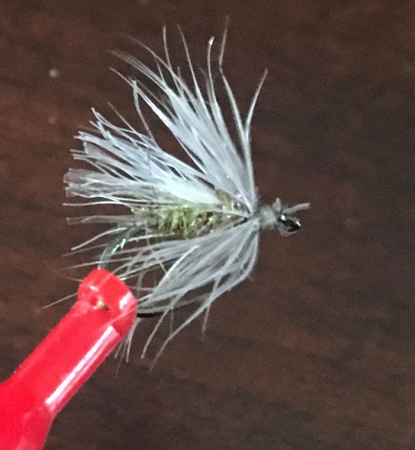

I was thumbing through some old Fly Tyer mags and in Spring 2015 came across a fly called the Lavender, tied by Igor Stancev.
It is similar to the Jupiter in that it had a flashy underwing.The original had a CDC hackle, ice dub body and used Lavender Angel Hair for the wing.
I stole their idea and my version has seen the water on the upper Metolius and racked up large numbers of the smallish rainbows in that part of the river...the Jupiter is surely going to work too.. as soon as I tie some.
Here's my version of the Lavender... mine uses Hareline UV Minnow Belly for the wing and a dun hen feather for the hackle... it worked wonders when there were small mayflies coming off in the mornings..
the head is a little messy and the photo isn't very sharp..but you get the idea...
