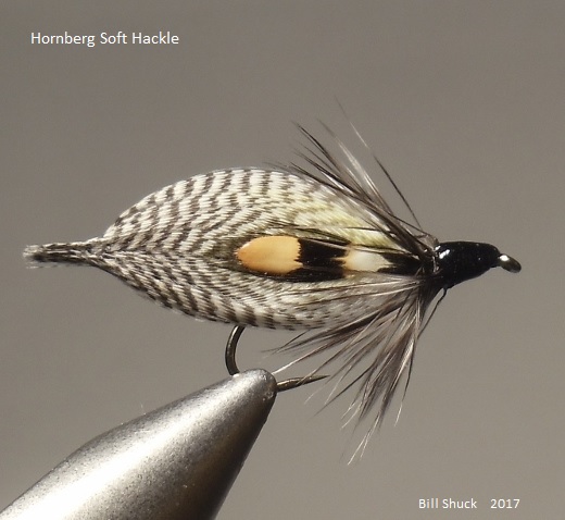

Post by tie2fish » Fri Feb 24, 2017 8:52 am
More than 10 years ago I read an article in a fly tying/fishing mag about a supposedly "magical" pattern called the Hornberg Special. Originated as a dry fly by a central Wisconsin game warden named Frank Hornberg in the 1920s, the pattern has undergone numerous variations over the years, including changes in color schemes and substituted materials. But the basic principal has remained constant: an underlying "warm" color showing through an outer veil of barred flank feather. The literature suggests that this pattern was designed to imitate a caddis fly, but it has been fished as a dry and as a wet so successfully over the years in sizes ranging from #4 to #14 that this comparison no longer seems appropriate.
I had some remarkable results with this pattern years ago, but got out of the habit of keeping any in my boxes. Having time currently available and memories refreshed, I have recently tried to tie some in a size small enough to not spook the trout I usually encounter and quickly remembered that it is not an easy pattern to tie. Perhaps that is why I got out of the habit of carrying them. Below is the recipe I am using that pretty much conforms to the original except that it results in a wet fly rather than a dry.
Hook: Daiichi 1710 2X long nymph hook, Size #12
Thread: 6/0 black
Body: Flat silver tinsel (NOTE: Because I want mine to sink, I'm adding some wraps of .010 wire under the tinsel)
Underwing: Paired yellow hackle tips mounted back-to-back on top of the hook shank, 1-1/2X hook length
Overwing: Paired mallard flank feathers tied to sides, also 1-1/2X hook length; tips of wing feathers stroked to point and glued with head cement
Eyes: Jungle cock nails (glued to mallard flank with rubber cement prior to wing mounting)
Hackle collar: Hen grizzly (as opposed to rooster grizzly hackle)
Head: Tying thread wraps finished with multiple coats of head cement

Re: Hornberg Soft Hackle
Post by Old Hat » Fri Feb 24, 2017 9:28 am
Love this pattern Bill. You did it justice for sure! It has always been on my to tie list but never made it to the vise. Funny thing, I just revisited this pattern a couple days ago looking for possible patterns for small baitfish. Something I would enjoy tying as opposed to all the EP fiber stuff people like to use down here. I was thinking a size #4-#6 with gold spoon eyes. Now I will definitely have to give it a go and let you see what I come up with.
Post by UC Steve » Sat Feb 25, 2017 2:20 am
This was a popular fly in New England when I was a kid. My grandfather tied a beautiful version, with dry hackle, & used it for Maine & New Hampshire landlocked salmon. They'd fish it dry until it sunk, then fish it wet. Grampa said when wet it imitates smelt & dace. The stiffer hackle may contribute vibration...
I think about the Hornberg once in a while but never seem to get with the tying program. Cool you did.
I turn green at the sight of that junglecock nail. :mrgreen: :mrgreen:
Post by letumgo » Sat Feb 25, 2017 8:42 am
Bill,
I enjoyed reading your write up, and seeing the soft hackle version of this pattern. I have been tying Hornbergs for many years, but generally in larger sizes, for use as baitfish imitations. I have used grizzly hen neck hackle for the collar. For streamers, I like a fairly full hackle collar. I feel it adds to the action of the fly (creates turbulence at the head of the fly and makes the fly flutter more on the retrieve).
One of my all time favorite variations of the Hornberg is the streamer version created by Bob Leeman. Several years ago I read an interesting article mentioning Bob Leeman's variation, of the Hornberg classic. His variation is tyed specifically as a streamer pattern. The Leeman version includes a couple grizzle hackles on each side of the fly (under the mallard flank feathers).
Here are the materials for Bob Leeman's Hornberg Streamer variation:
• Hook: Daiichi Model 2220/Size 6 (4X Long/1X Heavy Streamer hook)
• Thread: Black 6/0 (UNI-Thread)
• Body: Flat silver tinsel
• Wing: Sparse yellow calftail (tyed long), flanked by four grizzly saddle hackles (two on each side tyed along hook shank)
• Shoulders: Mallard flank about half a wing length (tyed parallel to hook shank)
• Collar: webby Grizzly hackle collared and tied back
• Head: Black tying thread and two coats of clear nail polish
