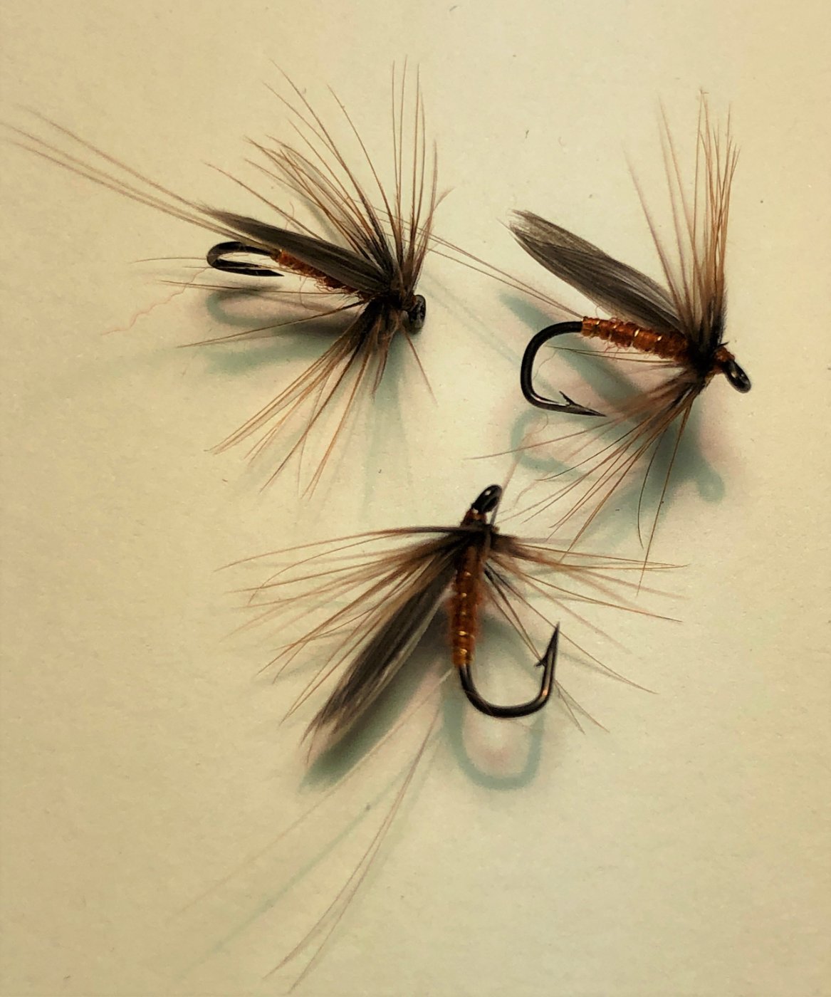

Post by Greenwell » Fri Feb 08, 2019 8:03 pm
Rusty Spinners.jpeg (201 KiB) Viewed 6548 times
Sorry for the poor quality photo but this should give a good idea of my interpretation of the Red Spinner wet fly.

Post by wsbailey » Fri Feb 08, 2019 8:21 pm
Thanks John. That’s exactly what I needed, a photo.
