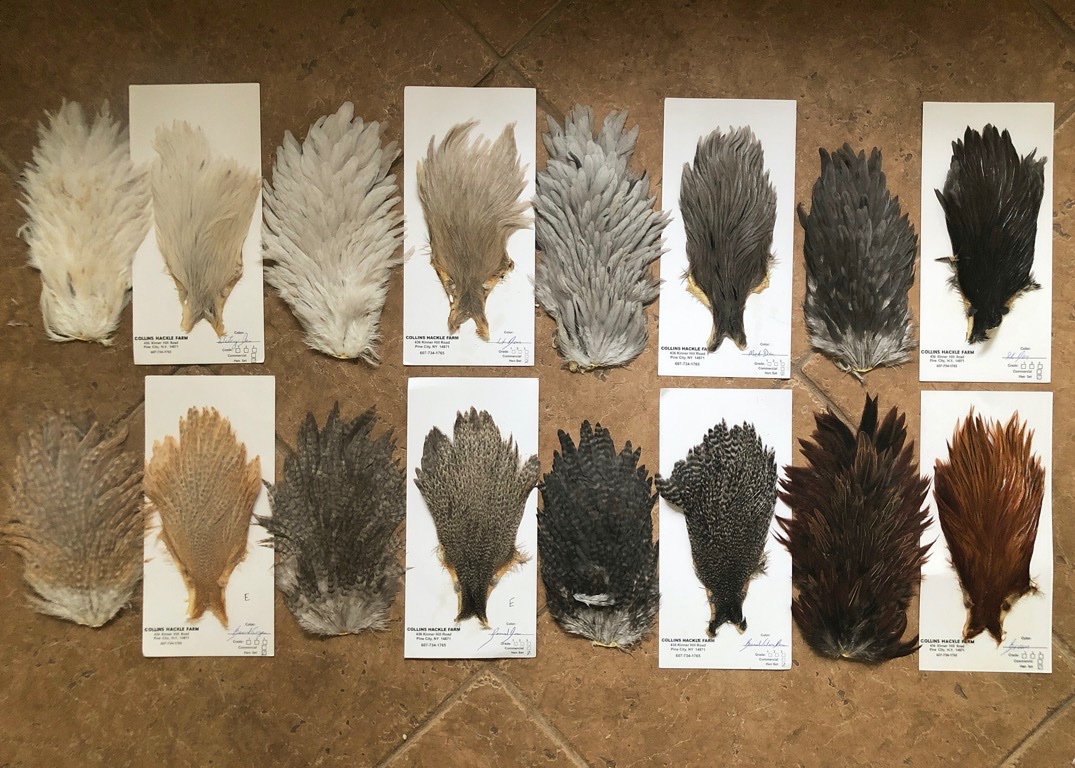

Neither his website nor his ordering methods are sophisticated. You can just mail him your order and a check. Your order arrives shortly with little communication. Lol. But, he is very nice and reputable and sells only quality. The best part is, for the price, you get both the hen cape and the saddle. So you can use the cape and some of the smaller saddles for your trout flies and the larger saddle hackle for your Florida fresh and salt applications. Here is a photo of my last order. I couldn't have been happier with it.

I also use Whiting hen capes quite a bit and there are feathers on the cock saddle that can be used as well. A saddle will give you some use near the base of the feathers where the the softer material is found however the stems can be a little thick in diameter. But, then you can use the saddle feather ends for deceivers and such. The Whiting hen capes can be a little stiffer and not as soft as other wet fly hackle but don't think a wet only has to have very soft hackle. There is plenty of on-the-stream applications for stiffer hackle on wet flies. Jim's Fly Co. has a great selection of both Whiting cock saddles and Whiting hen capes. Just call Jim Slattery and let him know what you are after.

Collins Hen Sets - Inexpensive (around $25 bucks for the matched pair/neck and saddle). They are a really great value, but can be messy (not always clean - I've had to wash all of mine before tying with them). Note that the neck hackle and saddle hackle are often wildly different coloration. This can be a positive and negative. Positive - variety is the spice of life. Negative - if you are ordering theses sight-unseen, you may be surprised by what you get. I love the Collin's hen sets and have a bunch of colors. Very nice to tye with (after cleaning).

Ray just gave you an excellent example of what's out there, and what to expect. I have tied with Whiting hen, Whiting Herbert Miner, Metz and Collins Hackle, and really, you can't go wrong with any of them.
Ray is right though about the Collins not being as clean as the others and I found their barbs to be not as much in quantity as say Whiting or Metz, but if you want to tie sparse hackled wets, Collins I think will suit you just dandy. And Mr. Collins is one of the nicest guys you'll ever talk with.
If you do buy Collins Hackle, also add your phone number because if he's out of stock on a certain color, he will call you and see what else you may have in mind. Also, his capes and saddles are a bit smaller too, but if you clean them up, they are worth the money.
