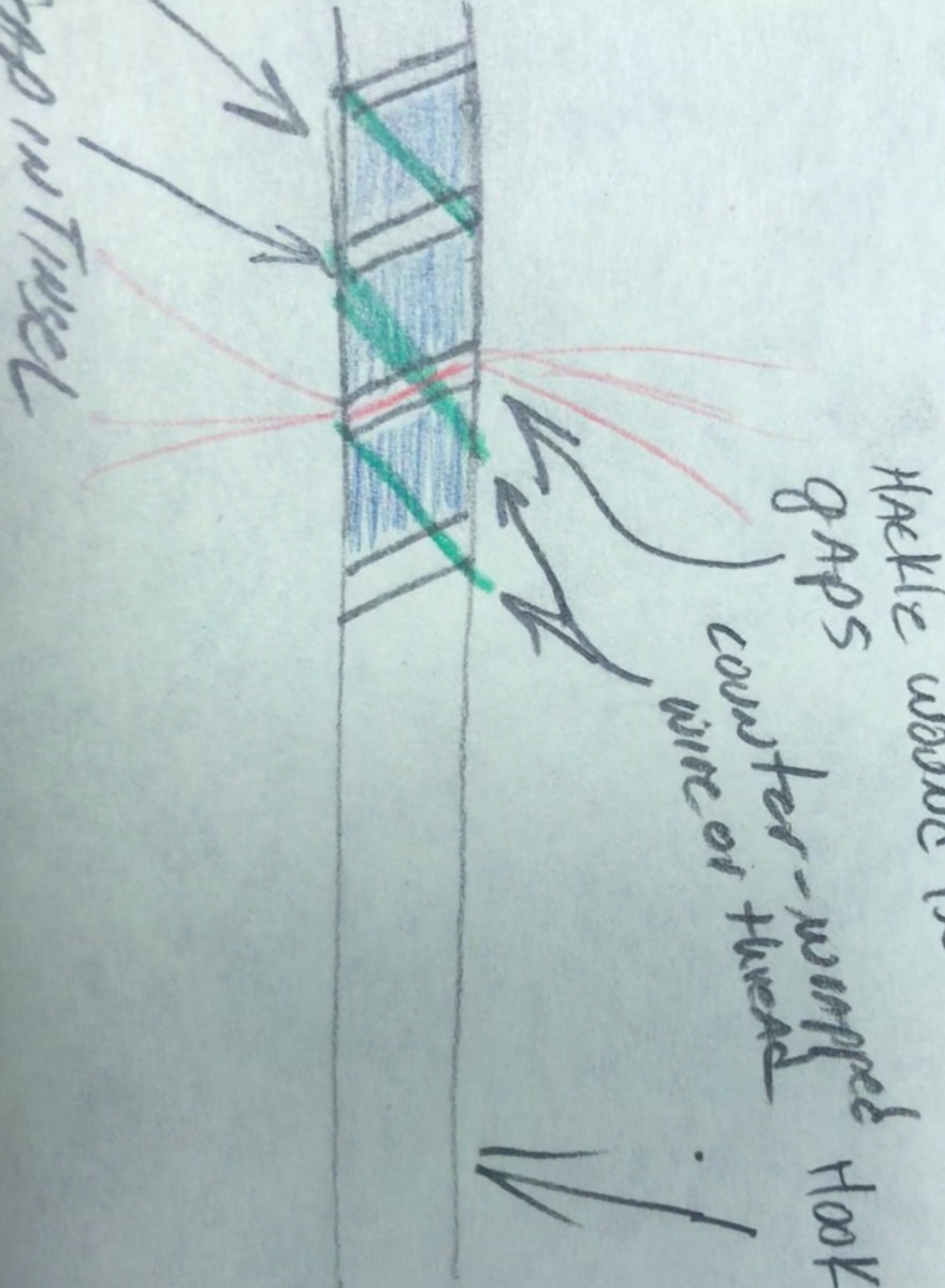

I happen to favor the bivisible, or buzz style of fly -and I fish them quite frequently. Some I use tinsel for the body, others dubbing. I have found when using tinsel, leaving a small gap between wraps instead of using touching turns will allow the hackle stem to sit between each wrap, and afford it some protection from trout teeth. I then counter wrap with Silk, and it makes for a very strong, durable body. See my attempted sketch, attached.

Post by tie2fish » Wed Oct 31, 2018 2:59 pm
Clever, Dana. Gotta try that!
