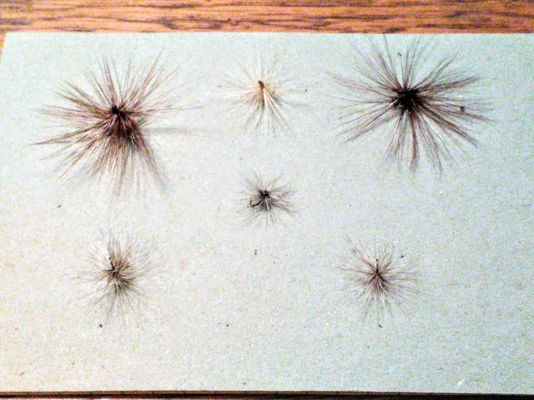

Contrary to popular belief Skaters were also tied and used in much smaller sizes. This group ranges in size from
2 1/2 down to 3/4 of an inch. Still today you would be hard pressed to find the quality of Hackle used in the smaller sizes in this bunch.
It pretty much has been bred out. .
Tom.

Tom--those are exemplary skaters that you have--the forward and backward facing hackle fold into each other nicely. Even back in the day, the right hackle was not easy to find. In Joe Brooks' essay on Skaters, the MS which I was able to procure a little while ago, he quotes Dan Bailey on the scarcity of the right hackle--and Dan added that a tier would have to charge $10 per fly to cover the trust cost of tying the flies.
A few years ago when I wrote to Charlie Collins to see if he had a couple of older birds, he said it didn't matter any more--the hackle had, as Tom says, long been bred out of commercial tying flocks. With his spades you could tie a smaller Skater. For my part I've sought hackle from flocks here in the midwest where the genetic line isn't so pure. But even the best hackle comes in at about 1 1/4"--giving a maximum spread of 2 1/2".
I consider anything over 2" a great Skater--and as Tom says, small ones were often tied and used too. If getting the right sized hackle is hard, getting the right stiffness is harder--which is why I don't like Coq de Leon. You want the forward and rear-facing hackle to cross over just right so the fly can stand upright and pass the "Ralph Graves Test," as the myth goes:
I'm not convinced this really matters on the water any more that the sometimes cited knife-edge matters--as long as the tips marry reasonably closely, they'll skate nicely on the water.
Here's some of the last batch I tied, the largest are a little more than 2 1/2 inches across--4 to 5 hackles each, and a lot of time and patience for each one--but they are worth it.
