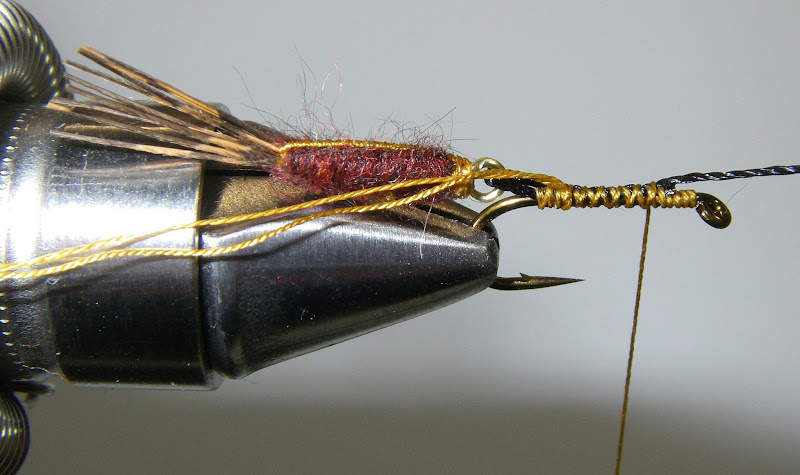

Here is a fly created with the wiggle tail extension.
I use a small loop of black beading cord to join the wiggle tail extension to the hook. You can buy the stuff in the jewlery section of your local JoAnne Fabrics/Walmart/Michael's/etc. The stuff comes on little spools that look like this.
This stuff is very flexible and yet very strong. I think the breaking strength is in the 20 to 30 lb range.
Here are a couple photos showing the intermediate step.
