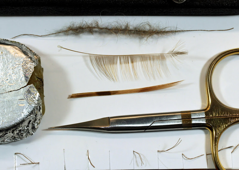

Materials all prepared and ready for tying: (prepared silk dubbing brush, hackle stripped, pheasant tail fibers, wax & sissors)

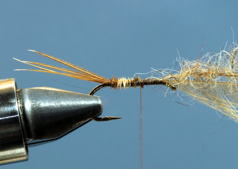

Dubbing brush tyed in and wrapped to the midpoint of the shank. Clip off the tag end of the silk and the butt end of the hackle stem. Now that I think about it, this is an important detail in helping to form the body taper. The silk thread and hackle stem, help build up the front of the fly a tiny bit, helping form a tapered profile in the finished fly. (Step 5/6 - along with a new intermediate detail)
Tying in the pheasant tail fibers (I should have evened the tips again - oh well, I was focusing on the photos, rather than my tying): (Step 7)
Pheasant tail and tread wrapped to the midpoint of the shank, secured and ends trimmed off: (Step 7)
Dubbing brush wrapped back to the midpoint of the hook, secured with the tying thread and excess trimmed off: (Step 8)
