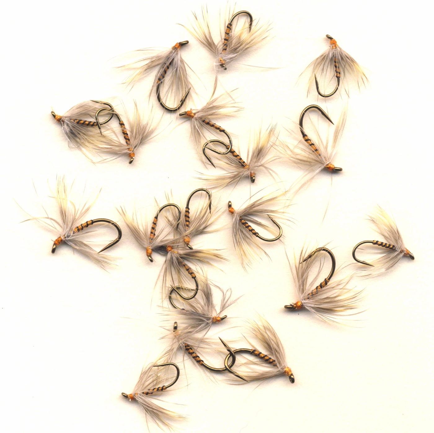

As promised, here's a pic the Water Crickets I tied last week.
- T E Pritt's No 1 Water Cricket.JPG (357.11 KiB) Viewed 5442 times
Re: Golden Plover Breast Feathers
Worth the wait. Gorgeous flies.
Very nice work, Bob. I noticed you vary your hook weights - this is an important technique which is rarely discussed. When a flymph in the film is the order of the day, I use either Partridge L3A or Daiichi 1480. For just below the surface, any medium wire Limerick bend, such as the Mustad 1921/1928/9002 is the ticket. Mid-water mandates a heavy wire hook such as the Daiichi 1760, or Mustad 7957BX. Also, the Mustad 3906B is a great "between" hook. Yes, weight may be added to the hook, but too heavy is not good either. Your fly must be where the fish are feeding!
