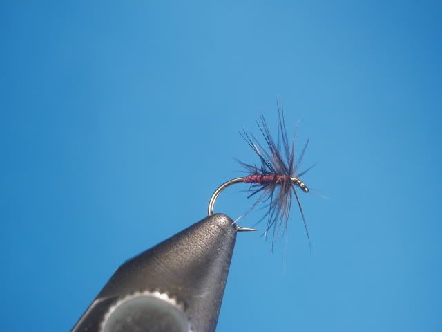

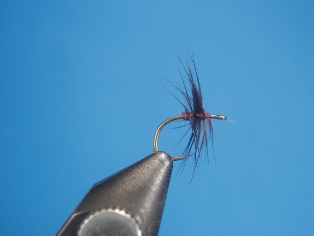

Post by Johnno » Sat May 07, 2011 5:53 pm
A couple of similar versions (Difference being the hook) of Stewart's black spider. Tied with claret Pearsalls. And tied off at the rear. I have used these with some success recently as part of a team of three wets/softhackles on our late season hatches. Also been using ones made in the same manner with a lighter brown silk with a slate coloured spur winged plover feather. Better refelcts the colours of our local small late season hatching mayflies..

Post by letumgo » Sat May 07, 2011 6:02 pm
John - Could you elaborate on your comment "tied off at the rear"? I am intrigued by the comment. Are there advantages tying in that way?
Great flies by the way...

Post by Johnno » Sat May 07, 2011 6:13 pm
Ray, I wrapped the hackle around the thread then wound backwards and tied off the "head" at the rear of the fly - if you look closely, you can see there is no head to speak of at the front
Re: Stewart Black Spider variation
Post by letumgo » Sat May 07, 2011 6:21 pm
Glad I asked. That is a terrific technique. I've tyed other portions of flies "backwards", but never tried your method. Need to give it a go. Thanks mate.
