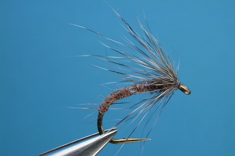

Post by Hans Weilenmann » Tue Apr 14, 2009 5:25 pm
Pining Away
Hook: Ashima F-45 #14 (or equivalent scud hook)
Thread: Benecchi 12/0, grey
Hair hackle: Pine squirrel
Rib: Fine orange copper wire
Abdomen: Tan dubbing
Thorax: Argentinean hare, dark grey
Cheers,
Hans W

Hans: What technique do you use to tie on the pine squirrel hackle?
Hans Weilenmann
Posts: 2109
Re: Pining Away
Post by Hans Weilenmann » Wed Apr 15, 2009 7:59 am
5feathers,
Split thread is always an option, but not used in this instance.
A bunch of the squirrel guard hair is tied in first, tips pointing over the eye. At this time the 'hackle' length is determined.
Next the remainder of the materials are applied. Finally the hair is pushed back over the body and positioned with a few tight wraps of thread, before finishing off the fly.
Please note that the angle and density of the front slope of the thorax plays an equally important role in how the hair hackle will angle.
Cheers,
Hans W

Thanks, Hans. Did you ever try to spin the hair around the hook as the last step? I'm going to give that a try.
Bruce
Hans Weilenmann
Posts: 2109
Re: Pining Away
Post by Hans Weilenmann » Wed Apr 15, 2009 4:44 pm
Bruce,
It is an approach, but not one I would advocate. Little control, and a lot to cover up when finishing the fly.
Cheers,
Hans W

Post by Soft-hackle » Sun Apr 19, 2009 9:09 pm
Hi Hans,
I've had a small problem with the technique you use. I've used it myself, and perhaps the hair I was using was a little too stiff because the head did not hold it in position after fishing a while. Don't know why it did this except for what I've mentioned already. Very nice fly for sure.
Mark

Post by Hans Weilenmann » Mon Apr 20, 2009 12:12 am
Mark,
You do need a gentle slope of the thorax just behind the hackle, and in some cases even a tiny amount of 'empty' space in front of the thorax, to enable the hair hackle to be positioned and fixed with the hard wraps. A permanent crease in the individual hair strands is key.
The type of hair of course also plays a part. Marten or mink are quite resilient, and need to be brought to order sharply. The pine squirrel used in the Pining Away is more obedient 8-)
Cheers,
Hans W
