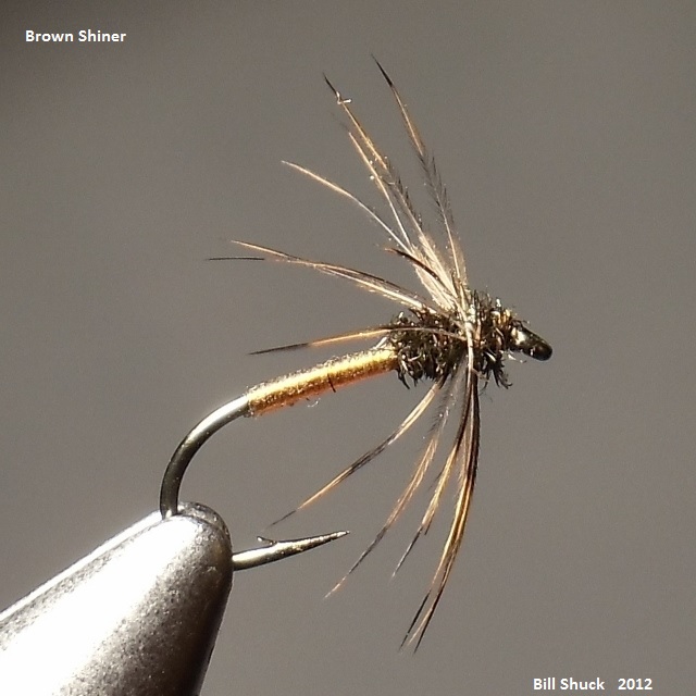

Post by tie2fish » Mon Aug 01, 2011 8:41 am
hankaye wrote:t2f, Howdy;
x2, of what Ray & Mark R. both said.
Would also be courious to see the other Variation.
Thanks,
Here's the "Brown Shiner with Herl Head" version. I left the thread a little 'flatter' for the body this time to get a smoother finish.

Am I right that "flatness" is not only a matter of unwinding the thread, but also of thread pressure? The abdomen of that second fly just looks....torquedI--I hope you're wearing safety goggles. :)
Re: Brown Shiner
Post by tie2fish » Mon Aug 01, 2011 1:26 pm
That's funny, CB :D . I'm sure thread pressure helps to flatten out the thread, but the main reason I pull hard on it is because it really enhances the transluscence that wax imparts to silk.

Post by William Anderson » Mon Aug 01, 2011 1:49 pm
Bill, these are wonderful ties. I especially like the second version with the longer hook and peacock head. It's wonderfully done all around. Gorgeous hackle section.
The light orange silk with your wax has a nice quality.
