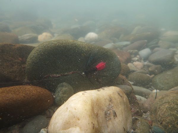

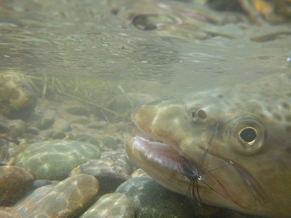

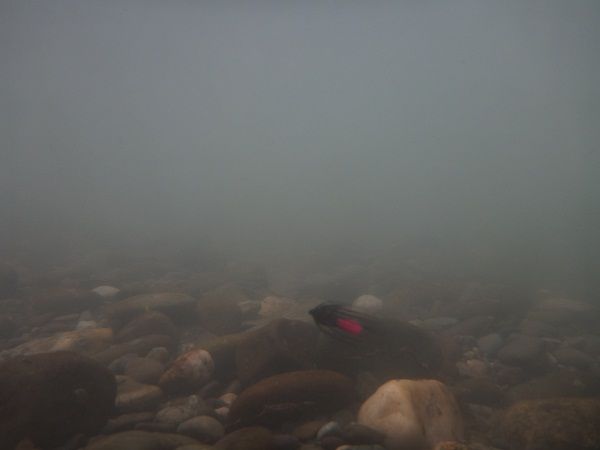

Re: Goats Toe anybody?
Post by Mataura mayfly » Wed Oct 31, 2012 11:27 pm
Donald, (and anyone else reading along) I tied up a couple of 2Xl #10 Goats Toe's on Kamasan B 830 hooks today using embroidery yarn for the tag and rib. The yarn I have is six strand, I separated the rib section into three strands, but did use the up-down wraps of the herl which did give a nicer looking body.
I doubt the head cement was dry on this one and it was going for a swim. Thought you might like to see what they look like underwater.......
I did not use any form of under hackle on these, just the peacock feather, doubled and wrapped twice.
Bit of a crappy photo set and the water was not as clear as I would have liked, but that is "swimming" at the end of the tippet in fairly strong current and the hackle does not seem to collapse.
The locals seem to like them.
