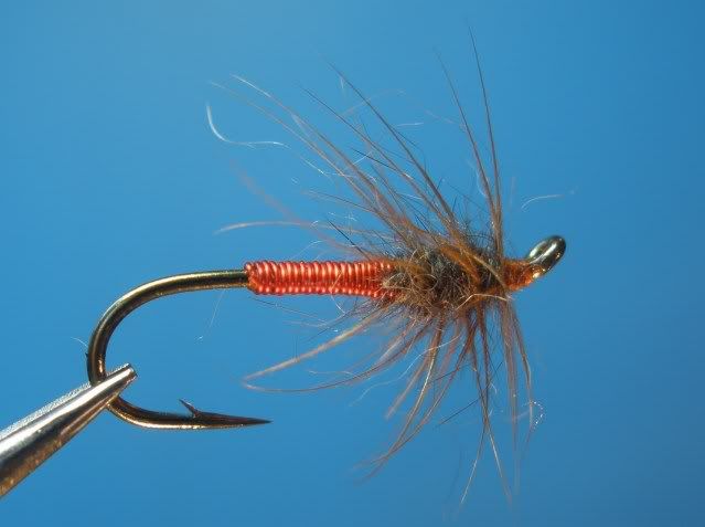

Post by William Anderson » Tue Mar 22, 2011 7:43 am
Another attempt at combining an attractor with something familiar.
Hook: Daiichi 1740
Body: Red Uni-wire
Hackle: Brown Hen
Thorax: Natural Mole with a pinch of beaver

Boy, these wire body flies your commin' up with are a great group of patterns. You should gather them all up in book form, and perhaps think about publishing something..... ;)

That thorax/hackle work is amazing -- it looks as though the "legs" are growing right out of the body. A very realistic impression to my eye.

Post by William Anderson » Tue Mar 22, 2011 8:58 am
Bill, I first saw this thorax/hackle technique about 6-7 years ago from Jim Slattery and it left quite impression. I tried really hard as a novice to get that effect back then knowing it seemed right for this type of fly (his pop-top patterns are a real benchmark).

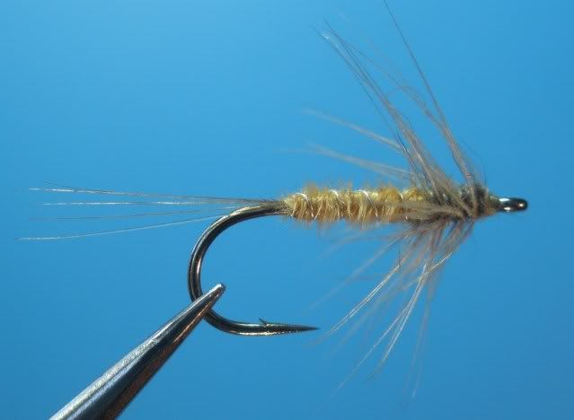

Here's a sulpher pattern from a couple years ago with yellow turkey flats as the body.
His flies were the goal I aspired to when I started. Luckly, I've got years left to try and get there.

Post by hankaye » Tue Mar 22, 2011 9:56 am
Dub-Ya, Howdy;
That is an amazing way to ...what would you call it Palmer the hackle thru thr thorax?
How'd ya do that?????
Re: Brown and Red 1740
Post by William Anderson » Tue Mar 22, 2011 10:09 am
Hank, you're exactly right. It's a common technique that dates back a long time, probably inspired from Stewart's flies (Baillie's) little soft hackles, or some of the historic midge patterns where the hackle is palmered down the body lenth. We do it with a Griffith's Gnat and others. The difference being the built up thorax on these emerger style patterns. This can be done a lot of ways, like everything else, but I strip one side of a hen hackle and bring it back through the entire thorax, which is left with soft compression in it. Then as you are going to bring your tying thread through the thorax you add a faint pinch of dub to the thread and wrap between the hackles. It keeps the hackles spread all lively and leggy. In my opinion, this makes for an improved (ducking for cover) hackle collared dry fly as well using stifffer rooster hackles instead of soft hen hackles. This is another technique to add to your growing reportiore.

Post by CreationBear » Tue Mar 22, 2011 10:45 am
Great tip: I've read that a full thorax behind a traditional collared soft-hackle helps "prop up" the hackle fibers, especially in heavy current: your variation of the Hidy flymph method seems to get the same "mechanical" effects very elegantly. :) (Of course, using fine dubbings like mole and beaver as you do might be a lot easier.)
A question about your wire-work, though: are you wrapping down to the hookpoint and back up on a bare shank, or is there a thread base under there?

Post by William Anderson » Tue Mar 22, 2011 11:05 am
Thanks CB. There is a thread base and a wrap at the end just because. This one was wrapped down the wire to the bend under the thread and back up, with a touch of dub to get a swell before the thorax.

Post by hankaye » Tue Mar 22, 2011 2:59 pm
Dub-Ya, Howdy;
Still courious as to how you get the wire to NOT spin round-n-round on the hook shank. With the thread base
or if you don't use thread do ya glue in in place?
