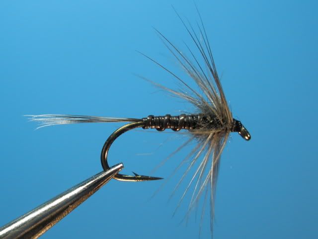

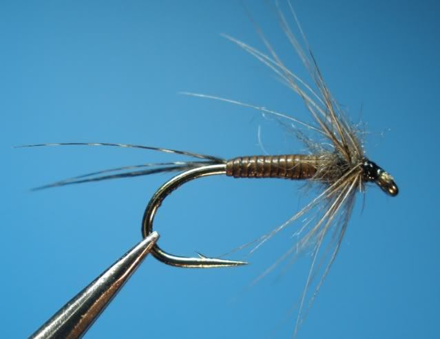

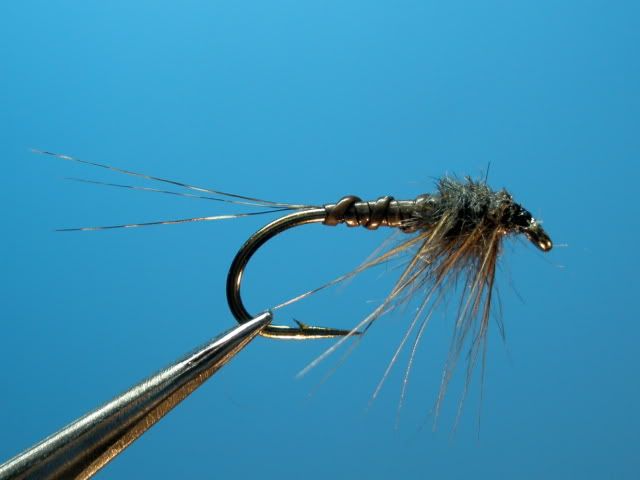

I've tied this pattern using porcupine guardhairs for years. Anyway, this year I tried something new and it just didn't work. I usually tie flies in sets of ten with a couple left over that didn't meet the standard, then pic the best of the batch and set it to the side. This year I tried to tie the Pork and Hen pattern using the wrap down and then rib back up with the body material, but it didn't work. I got one, but all the others bodies were inconsistent and some just sloppy, so I ended up tying a batch of the regular pattern, and kept the best one of each set . Here is the one rib version that worked, a solution for the one that didn't work (smiley) and the typical pattern.
I just turned them into nymph patterns. I still need to add a cap of epoxy on the wing pad, but I think these are still usable.

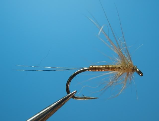

Here is a light version.
