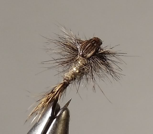

Thanks, Mike, for pointing out some of the details for this pattern. Here's a photo of one I tied earlier this year, and after reading your post I shall do at least two things differently the next time:
1) Use lighter colored and less hair for the tail, and, 2) try making the wing case out of mask hair instead of using pheasant tail barbs ...

Here is a dry fly ( sunk abdomen emerger) Using guard hair as hackle, and blended guard hair as a thorax. ( The abdomen is stripped peacock quill);
This fly uses guard hair for the wings, blended guard hair for the thorax, and blended flax with light underfur ( the darker fur is removed)for the abdomen;
This combination defines the function of the fly. ( More info here;
