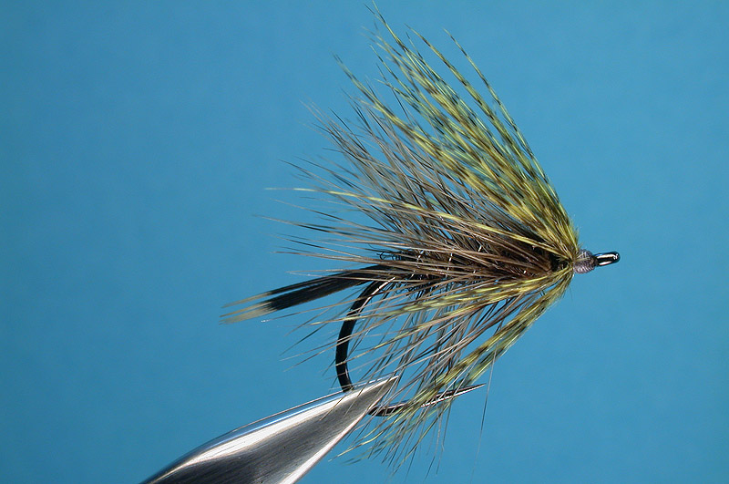

Post by Hans Weilenmann » Mon Mar 30, 2009 4:36 pm
Fern
Hook: Grip 14723BL #12
Thread: Benecchi 12/0, grey
Hackle: Pintail barbs, dyed olive
Body hackle: Grizzly, dyed dark dun
Rib: Fine silver wire
Tail: Jungle cock shoulder barbs
Body: Seal's fur, dyed black (or substitute)
Cheers,
Hans W

Hans Weilenmann
Posts: 2109
Re: Fern
Post by Hans Weilenmann » Tue Mar 31, 2009 12:47 am
Ray,
Close but not quite, at least not on these last two (Fern and Clockwork Orange). The pintail (flank) feather barbs are simply way too long for the hook size to wrap as a collar.
Here is the sequence I used.
For these flies:
1. Attach thread.
2. Stroke out&down a section of pintail barbs away from the quill to align the tips, grasp and tear off.
3. Bunch up the barbs, keeping the tips aligned. Hold them in the bobbin hand.
4. Slip the bunch over the eye of the hook, measure length of barbs, pinch them with off-hand, make a couple tight thread wraps to fix them in place.
5. Look at the bunch, re-check for length, and if needed adjust and tweak. You are aiming for barbs around the full circumference of the hook shank, but have more barbs on upper 180 degrees.
6. Tie in body hackle, by the butt, at this stage, keeping a couple thread wraps space between pintail tie-down and body hackle tie-down.
7. Wrap thread towards bend, trimming pintail barbs in stages to form a gradual taper. This is not absolutely required, as the body taper can also be built with the body dubbing, but why waste the opportunity.
8. Tie in ribbing wire
9. Run thread to bend, tie in tail material.
10. Apply dubbing and wrap body, leave (bare) thread hanging immediately behind the collar tie-down.
11. Spiral body hackle towards bend.
12. Trap body hackle tip with the ribbing material, and spiral rib towards eye, secure and snip/break off. Snap away tip of body hackle.
13. Push with tip of index finger or thumb into the eye of the hook to force the collar barbs to radiate perpendicular to the shank, move in with off-hand and pull the barbs around the body.
14. Make hard thread wraps in front of collar to fix the collar cone shape at the desired angle.
15. Finish off fly as per normal.
Note - if the collar material is wrapped, such as done in the Cloaked pattern, steps 3-5, 7, and 13, are modified accordingly.
I hope this helps.
Cheers,
Hans W
