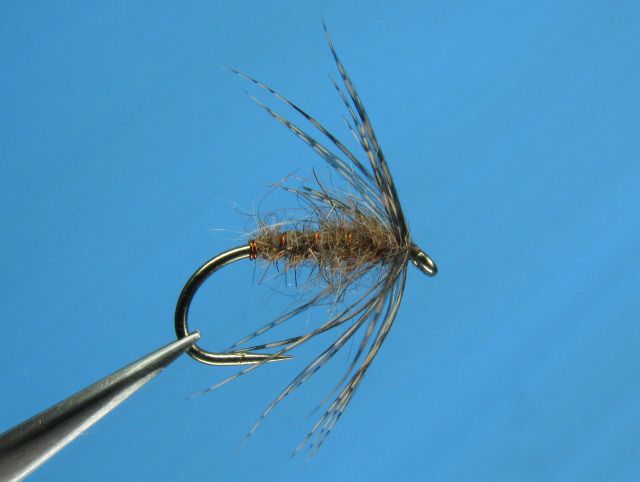

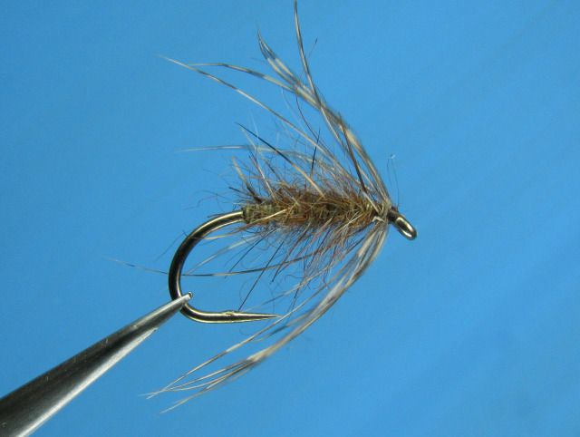

Post by William Anderson » Fri Jul 06, 2012 8:01 pm
I have been trying to reproduce my favorite Hares Ear blend so I tied a couple sets, and not leaving well enough alone, each set is tied with a slight variation. Basically the dubbing blend is a mix of several different masks, Natural, Dark Brown, Olive, and a touch of Burgandy and a pinch of Orange mixed with a pack of natural colored Haretron. I'm not sure I got it, but it's as close as I could manage. Note to self...write it down next time.
Hook: Daiichi 1530
Tying Thread: Brown 14/0
Hackle: Partridge
Body: Hares Ear blend #3 (on primrose silk for the dubbing block loops)
Rib: Small Dark Copper Uniwire (Drop Loop fly only)
Partridge and Hares Ear 1530 Drop Loop
Partridge and Hares Ear 1530 Block Loop
Partridge and Hares Ear 1530 Block Loop - More Guardhairs

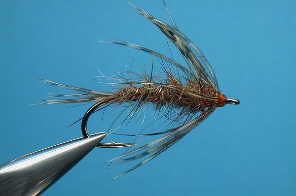

Ray, I don't have a ratio of the blend, just a small bit of what was a large batch to match. The first time I made this blend was several years ago. This fly was from that first batch, again the c.2007 era - the 1270 (200R) phase. Check out the head on this bad boy. :oops:
Hans photographed this fly for that swap.
I made another, larger batch of the stuff that was pretty close and I have caught more fish with this fly than any other...so it's kind of important for me. It and my "franken-shirt". :D

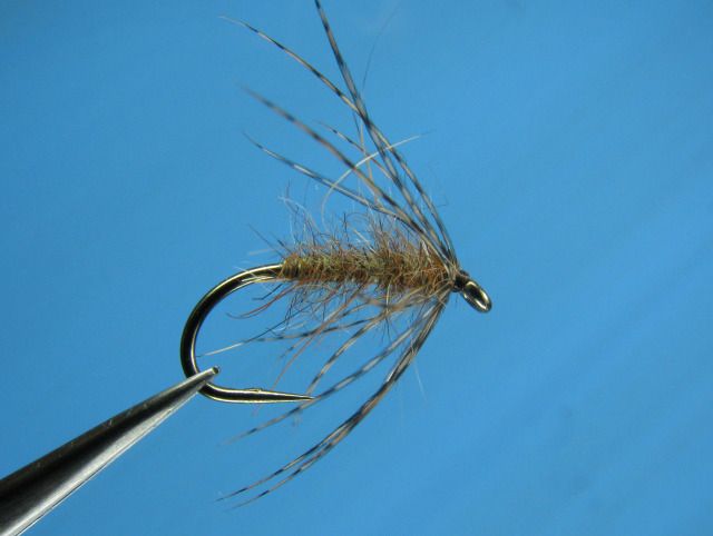

Here was the last incarnation of the blend...a more subdued variation.
I made some other spectral blends that get too complicated (seal, hare, opossum mixes) for my fly naming conventions, best to stick with single critter to keep things simple.
I will get back to this blend with some forward thinking rules, write it down as it works itself out.
Note to self...never include one of Hans' pics in the same post as one of mine. :cry:

First take a natural, a dyed brown and a dyed olive hare's mask and cut a bit (several snips) from the poll and the cheeks of each mask, almost equal parts of poll and cheek, and equal parts from each mask. I may go heavier on the natural mask. Blend that until you get it well mixed. Do the same with a dyed burgandy and dyed orange mask. mix it seperately. You'll only need about 1/4 the amount of the first mix. So technically its probably 6 parts natural, 4 parts brown, 4 parts olive. 1 part burgandy, 1 part orange. Blend that whole pile together. This will be a very spikey blend, similar to that 4th pic on the 1270 hook. Then add the mask mix 2 to 1 with the Hareline Haretron natural. The Haretron has a nice usable texture and blend on its own, but about the right amount of antron to make a subtle difference in this spectral blend and cuts the overall effect a bit. That should do it. The poll from each mask keeps the blend on the dark side, or maybe I use more of the brown mask. I have a lighter version too just using the lighter areas of the masks. Anyway, it's not rocket science, but there is certainly a trace of voodoo. It works...I don't argue.
