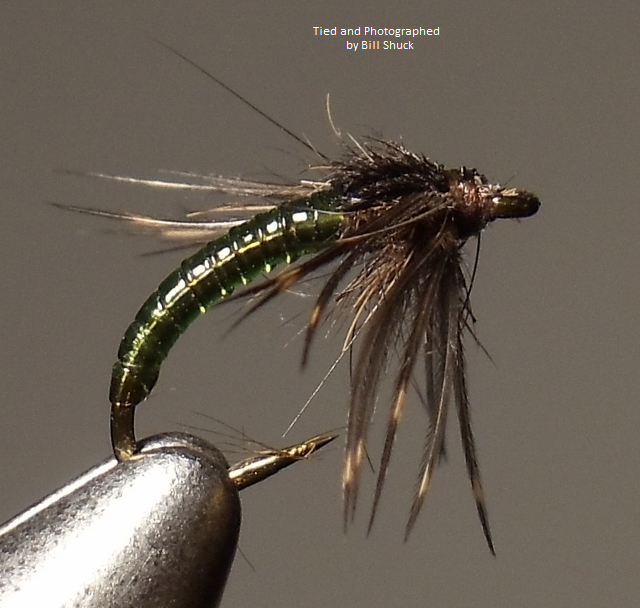

Post by tie2fish » Fri Nov 23, 2012 12:14 pm
Hook: Mustad C49S, Size #16
Underbody thread: Sheer 14/0, light olive
Finish/head thread: Uni-Thread 8/0, camel
Hackle: From neck area of English (red) grouse
Body: Midge tubing, light olive
Wing case: Dark mottled turkey quill fibers pulled forward and tied down after hackle wrapped
Thorax: Hare's ear in dropped loop

Very nice! I would fish that with confidence as a tube caddis nymph here........ which at times is 80-90% of a trouts diet in local waters.

Pardon me Bill whilst I pick up my jaw that I dropped when I saw this beauty! It looks very much like the caddis worms inside the cases that I picked apart while wading around in the Willowemoc. They were everywhere! Your pattern is excellent as always!

Bill, I really like this pattern with the grouse markings just setting it off. An especially nice touch to match thread for the head color. Another great pattern.
Wayne, you're tubing work this year has been a great inspiration. The pic of that natural really says it all.

Great fly but I would probably like it even more with a silver tinsel underwrap.

That's a great looking fly 2fish. Nicely proportioned case, the taper and curve is perfect. The buggy legs and antenae are also really good too, good work.
