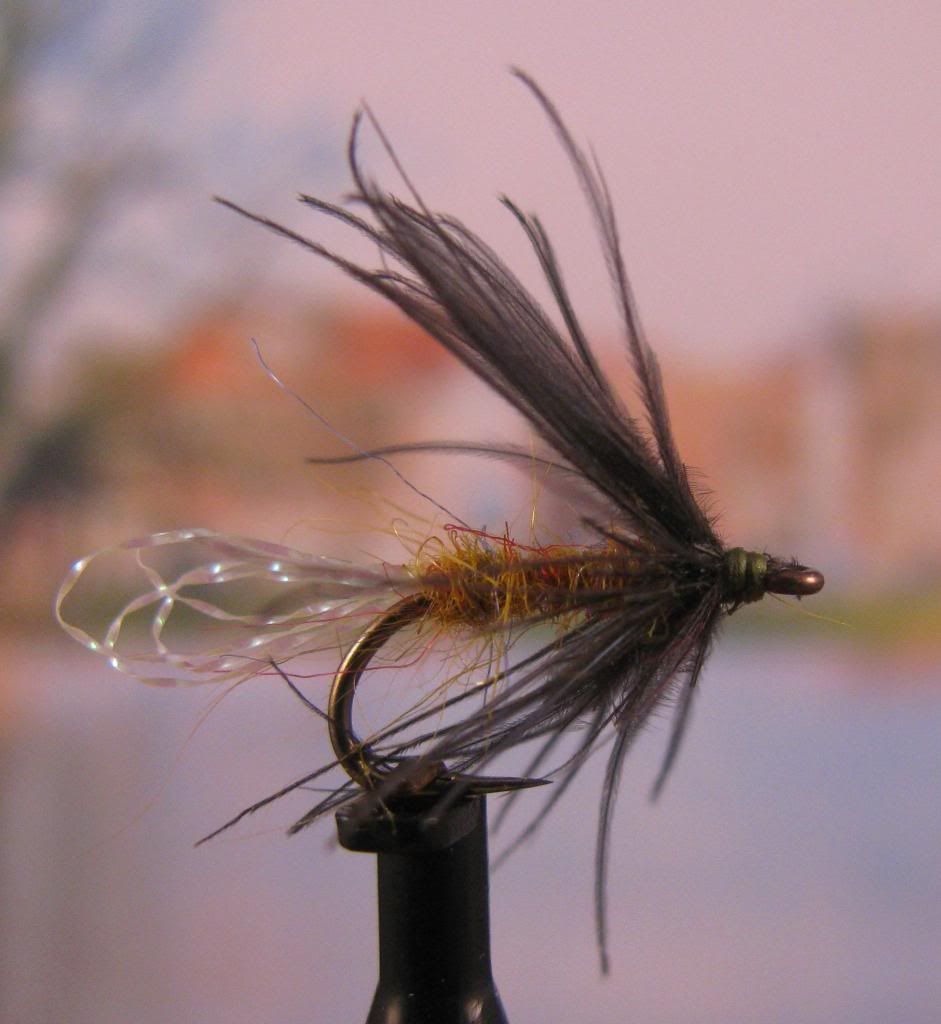

Wilted Spinach variant with Pukeko (WSP)
Hook: B 174 # 12
Thread: sheer olive
Shuck: loops of crystal flashabou (phosphorescent)
Body: dubbing: 50% yellow hare, 25% golden olive Seal, 25% Rainbow Firestar (thanks Ariel)
Hackle: Pukeko ( make a hackle with the thread) (Thanks Jeff)

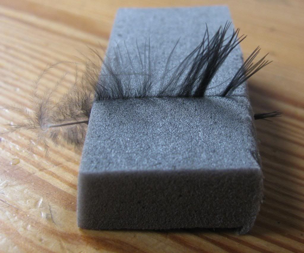

Feather in a piece of foam to make the hackle

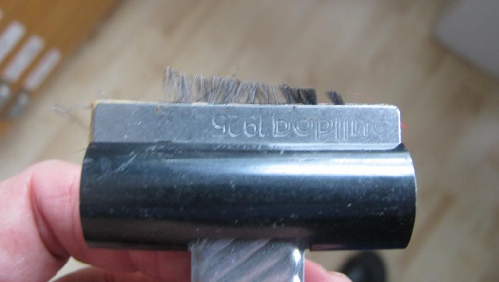

Feather in a kind of paperclip.
Here the stem of the hackle is cut off. These butts come in a loop of thread and then I turn a hackle.
