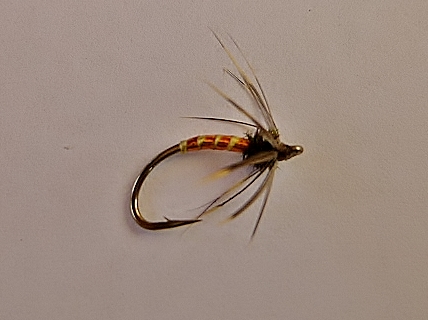

Hook: #12 Daiichi 1150
Thread: Camel Uni
Body: Copper tinsel over yellow floss -- I spread a drop of Hard Head on it to give the mylar tinsel more durability
Thorax: Dark peacock herl
Hackle: Plover wing covert
I like this one for meeting late evening red quills.

I like the material combination you have here, especially the yellow tips of the plover and the yellow floss peeking through the tinsel. Looks like a winner! How do you typically fish this fly?

Tom, on my homewater, the upper Columbia, I most often quarter, swing, dangle & lift -- downstream; often two nymphs on a cast. Though upstream & dead-drift as well. Whatever the situation seems to call for. This is one of my local staples, & it travels well. Good for western march browns too. I like it on June evenings when things are really dense & I want something with a bit more visibility to stand out in the crowd. I like the subtle 'squirm' the Daiichi 1150 gives the shape.

Have you tried the same pattern with smaller ribbing material, or tried twisting the flat tinsel into a rope? Would be an easy way to get variation in the pattern without changing things up too much and offer the fish a more subtle model in bright light conditions.......... just a thought...... not a recommendation! ;)

Thanks for the creative suggestions, MM. Yes, I've tried it with a thinner rib of copper wire, but that made it unbaetislike, as I wanted to simulate the wide chestnut colored segments we see on some baetis, with the yellow being secondary. I really like the twisted rib idea & haven't tried it, though I will now. As so many of the baetis & other mayflies, as well as the smaller stoneflies, exhibit this coloration, it's a productive one. Now I'm thinking the twisted rib, wound closer, might allow more yellow segments & still give the overall copper color I want. I'll try one that way.
