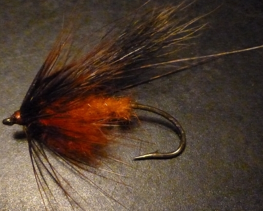

P1060184 (640x507).jpg (217.81 KiB) Viewed 6939 times
Inspired by Ray's pattern. Here's one that is working good for me this year.
October Flame
Hook: #8 TMC 200R or Dai-Riki 889 (Depending on location, naturals are #8-#10 – #8, where I fish – For big water holding large trout or sea-runs, I like a heavy wire steelhead hook, though a lighter hook might be more appropriate for trouting, skinnier water & smaller sizes.)
Thread: Rust-brown UNI 8/0
Rib: Fine copper wire
Body: Mix of 2/3 Umpqua orange sparkle dubbing & 1/3 Wapsi Superfine sulfur yellow dubbing, dubbed in a loop of the tying thread (Pumpkin orange on my home water, & that seems to be fairly common over the northern regions, though color will vary with location, pale orange to tan & yellow more common to the south into California. A wingless version of this pattern will fish for the pre-emergent pupae, but keep in mind that these are paler in coloration than the adults – a common mistake tiers make is representing the pupa with adult coloration – mixing in more of the sulfur yellow will give the lighter coloration.
Thorax: Flue taken from the base of an orange-dyed mallard flank feather – tie in around the center of the puff then fold back & arrange around the hook shank – the flue from one side of the feather tied in on top, & the other side tied in on the bottom usually does it, though it might take a bit more – this will extend over about half the body & when wet creates an enticing shroud
Antennae (Hind legs?): 2 mottled turkey tail fibers extending well behind the hook bend
Wing: Pine squirrel tail
Hackle: Furnace hen
I'm looking for info on ancient hairwing trout flies & not finding much. A lot on quill-winged wetflies, which seems to have been the most popular mode into the 1950's, yet very little on old hair-winged wetflies for trout. If anybody can help to inform the subject, I'd greatly appreciate it.

Steve,
This is a very nicely thought out pattern. I like the thorax addition and the attention to detail in the antennae.
I haven't seen a lot of traditional hairwing wet flies for trout. Of course there are a lot of hairwing streamers and not enough people fish these in small sizes IMO. I do tie few attractors for trout that are small versions of some of the classic hairwing steelhead patterns. Most of the small hairwing trout flies seemed to be traditionally dry patterns. I'm interested to see what you come up with.

Steve, this looks like another interesting combo. I can definitely see the steelhead potential here. Trout too. Great to hear it's been working for you and great to see a hair wing. It's unique to me and very cool. Looking forward to more reports.

This one is a beauty! I like it alot! Really well done! Please tie more of your handiwork and post it here!

"Well thought out" describes this to a T. Amazing.
