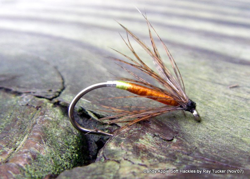

Candy Apple Caramel
Hook - Mustad Model 3906 / Size 6
Thread - Black UNI-Thread (6/0)
Under Body - Silver Mylar Tinsel (Size #14)
Mid-Body/Butt - Insect Green Danville Rayon Floss (One Strand)
Outer Body - Golden Brown UNI-Floss (One Strand split in half to reduce bulk)
NOTE - The golden brown floss body is painted with one coat of Superglue to give the body a hard shiny finish like a caramel apple. Allow the body to dry before going on to add the soft hackle feather.
Hackle - Ruffled Grouse Body Feather (One side stripped)

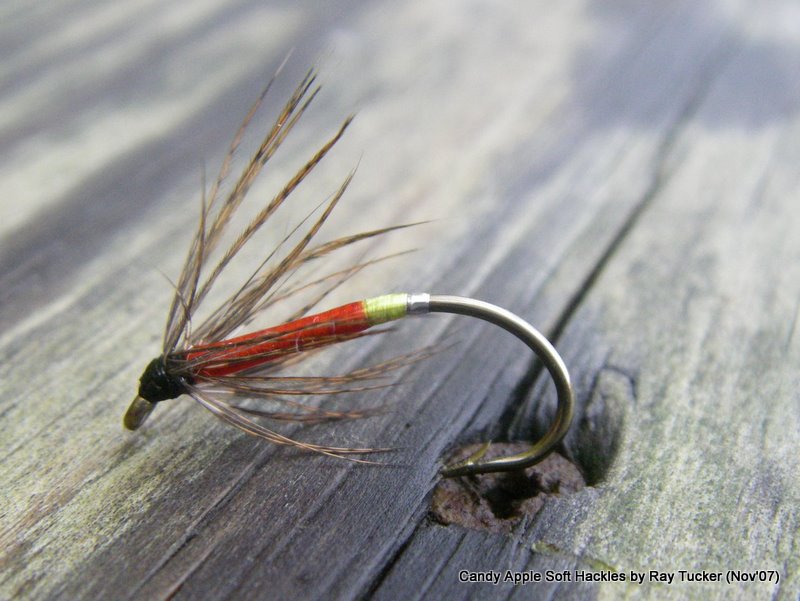

Candy Apple Cinnamon
Outer Body - Red Danville Rayon Floss (One Strand)
NOTE - The red floss body is painted with one coat of Superglue to give the body a hard shiny finish like a candy apple. Allow the body to dry before going on to add the soft hackle feather.
Re: Candy Apple Soft Hackles (Caramel & Cinnamon Versions)
Posted: Thu Nov 18, 2010 8:48 pm
by willowhead
BEAUTIFL........so you run the mylar tinsel down the whole length of the shank? i've done that usin' the Pearl stuff.....shines thru nicely when you only use a single strand of floss. Great looking flies Ray. The sparse Ruffled is really nice. ;)
Posted: Thu Nov 18, 2010 9:19 pm
Yeah, the tinsel is tyed in at the eye and wound to the bend of the hook and back. The process is then repeated with the green silk (just stop a little short so the tinsel tag shows) and then the outer color of silk (again stop a little short so the first color shows). The tinsel helps reflect the light back through the layers of silk, making the body more translucent looking. The superglue is used to give it a hard coat, durable body. The body can then stand up to many fish without getting destroyed.
