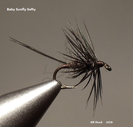

In a response to Bill Bailey’s post about an English rabbit skin, member daringduffer suggested that someone might make a flymph out the “Baby Sunfly” pattern. I glossed over this at the time, as I had no idea what the “Baby Sunfly” is or how it is related to an English rabbit.
During a later PM, however, he brought up this subject again and I decided I really ought to find out what the connection is and perhaps even pursue the challenge of tying the originally dry fly pattern a la Leisenring/Hidy. Information on the internet about this fly is relatively sparse, but I was able to piece together enough details to get a fair idea of what it consists of – enough even to attempt to tie it as a flymph.
An English clergyman, Rev. Edward Powell, fished streams in the Shropshire region in the Welsh borderlands on a regular basis during the 1920’s – 1950’s. He is credited by author Christopher Knowles (in his book Orange Otter) and others with developing as many as 26 fly patterns that were especially killing on these waters. One of the patterns he named the “Baby Sunfly” as it was a smaller, slightly modified version of a D. Lewis fly called “Sunfly”. It was strictly a generic pattern, as Powell was convinced that fish mostly wanted black and brown flies.
The rabbit connection comes from the fact that the fur used for the body of the fly was/is the quite dark underfur found on the face of the English rabbit (not the better-known-to-tiers "hare", which is a different critter). The dry fly recipe is as follows:
Hook: Sizes 12 – 18
Thread: Brown or black
Tail: Black or coch-y-bondhu cock hackle barbs
Body: Dubbed rabbit face, from triangle of nose & eyes, very dark, tied full
Rib: Brown thread, 3 turns
Hackle: Black or coch-y-bondhu cock hackle, as many turns as possible
I tied the below on a vintage Herter’s 423 TDE hook, Size #14 using Pearsall’s Gossamer #17 brown thread. The collar hackle and tails whisks were taken from a nearly iridescent black feather found at the back of a coch-y-bondhu hen saddle. Since I do not own an English rabbit mask, the body is a blend of hare’s poll and black wool spun in #17 Gossamer on a Clark block.

Re: Baby Sunfly Softy
tie2fish, Howdy;
Mr. Bill, your efforts to assemble something from not so much is masterful.
Great looking interpretation to 'morph' from dry to Flymph. Well done Sir!
- Posts: 2195
I knew you wouldn't let me down, Bill. Since the fly is supposed to represent a black gnat, or Bibio johannis, a dark fly seems appropriate. Dark and beautiful. It is said to be a generic fly, most successful early season.
Thank you very much mr Shuck.

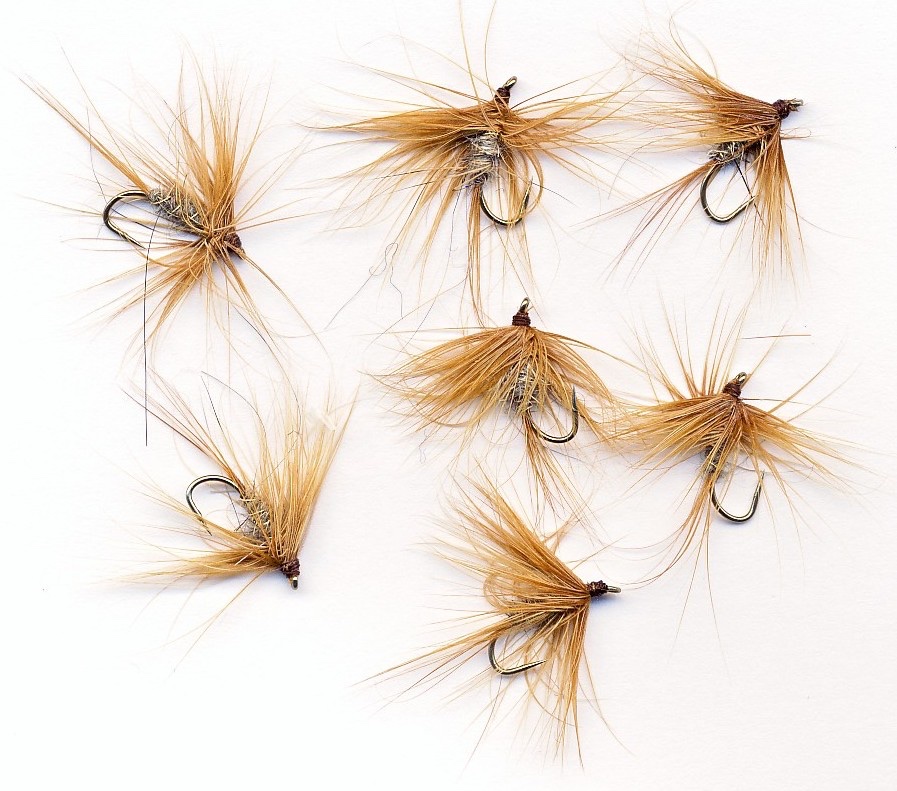

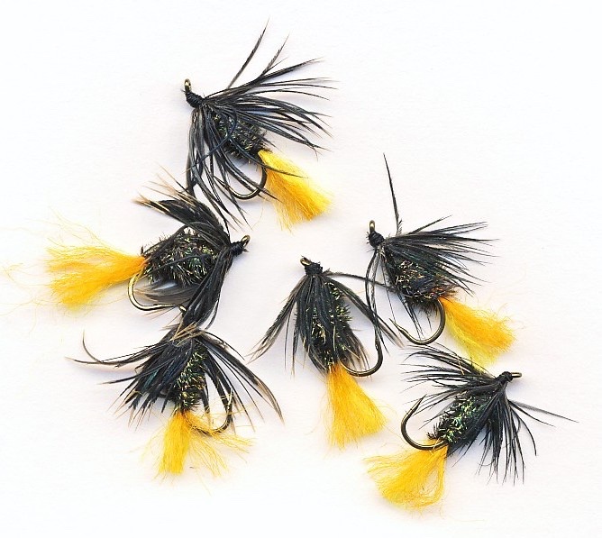

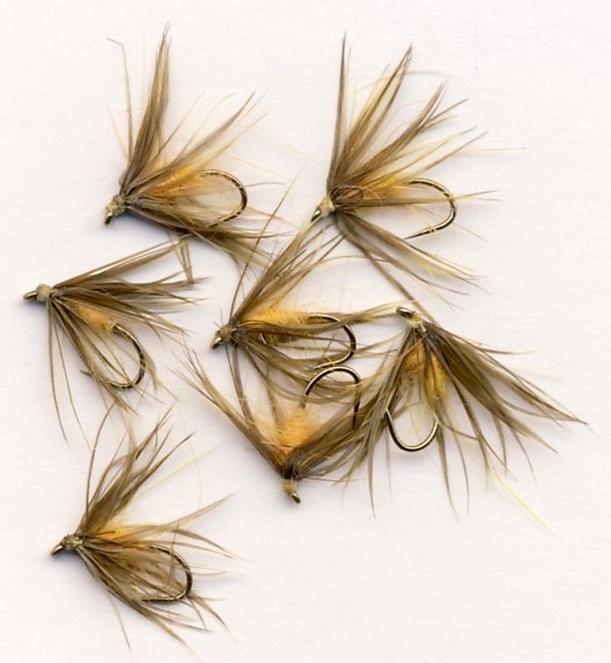

Several years ago, a friend in Europe sent me a copy of the Orange Otter book and I've read through it a few times. I got really enthused about the Rev. Powell's dressings and tied a few using the dressings in the OO book and also in a Mock's Morgan book on Welsh flies since some of Rev. Powell's dressings are supposedly adaptations of some other Welsh dressings.
- Powell's Paragons.jpg (212.65 KiB) Viewed 6561 times
- Powell's Landrail & Rabbit.jpg (87.07 KiB) Viewed 6561 times
- Powell's Gravel Beds.jpg (113.11 KiB) Viewed 6561 times

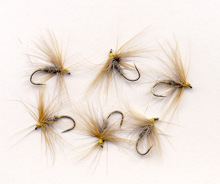

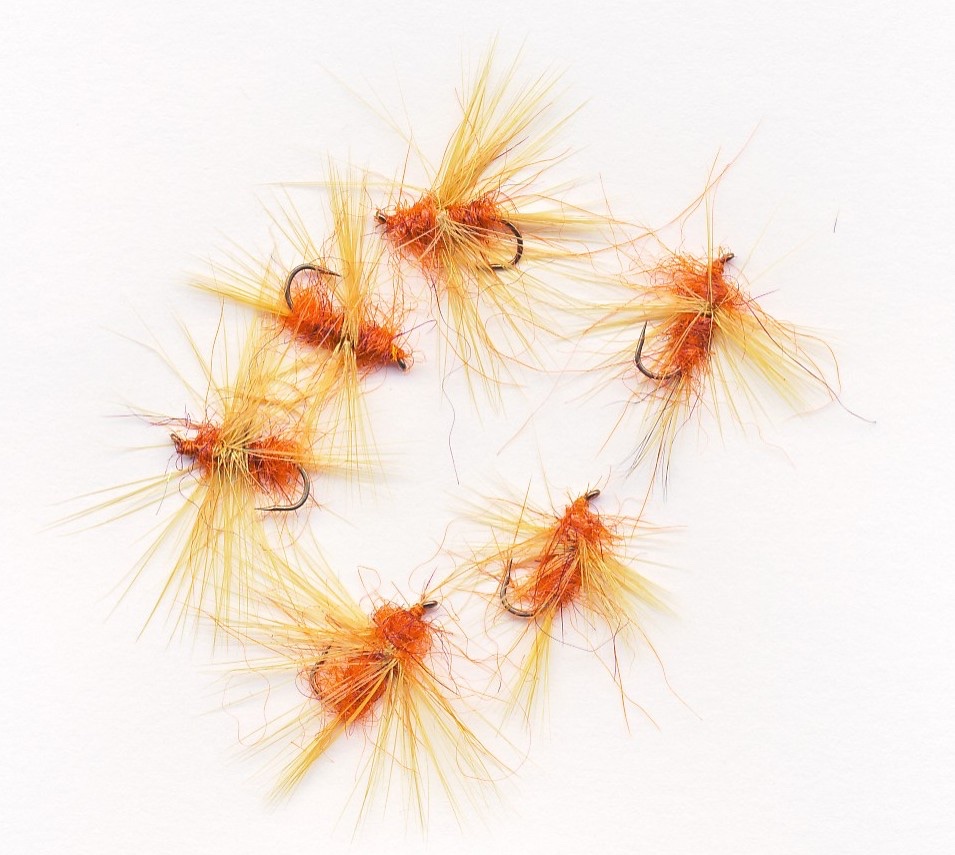

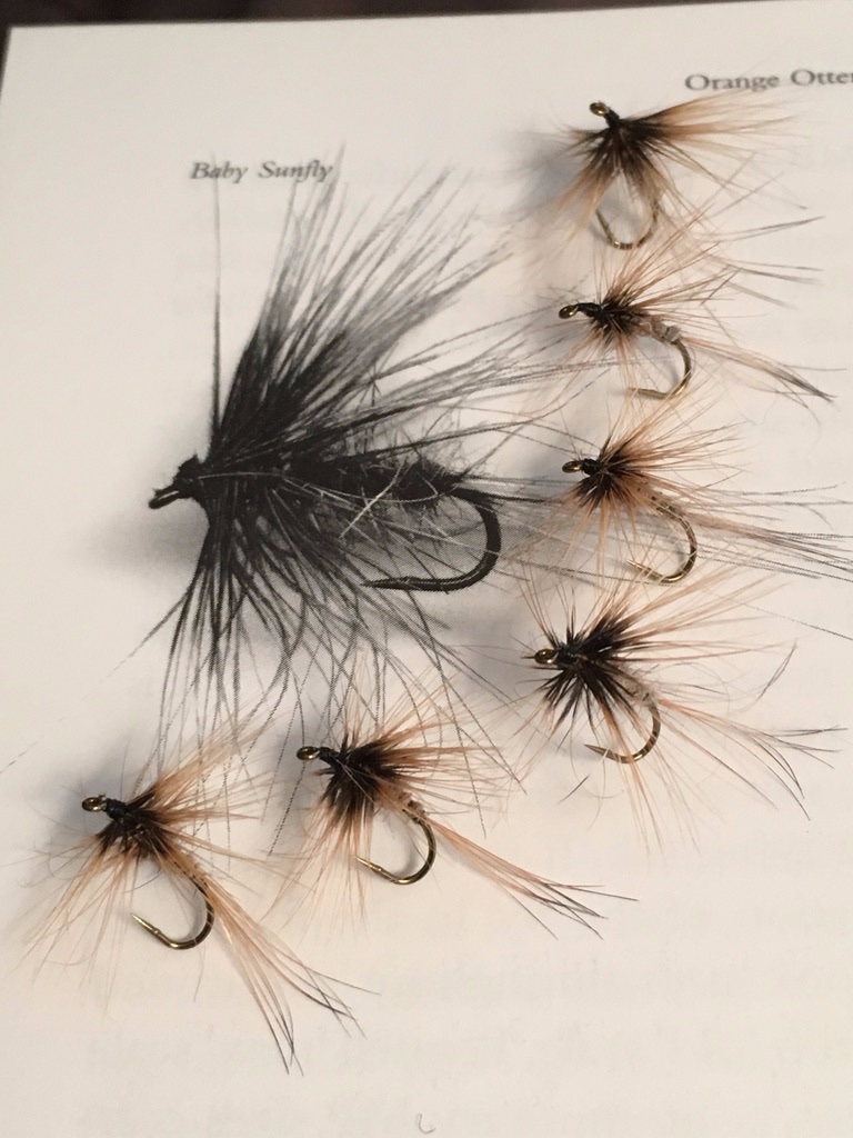

and a few more of my attempts at the. Rev. Powell's dressings
- Powells Baby Sunfly & Variations.jpg (193.73 KiB) Viewed 6561 times
- Powell's Squashed Beetle.jpg (123.68 KiB) Viewed 6561 times
- Powell's Orange Otters.jpg (194.32 KiB) Viewed 6561 times
Nicely done, Bob.
