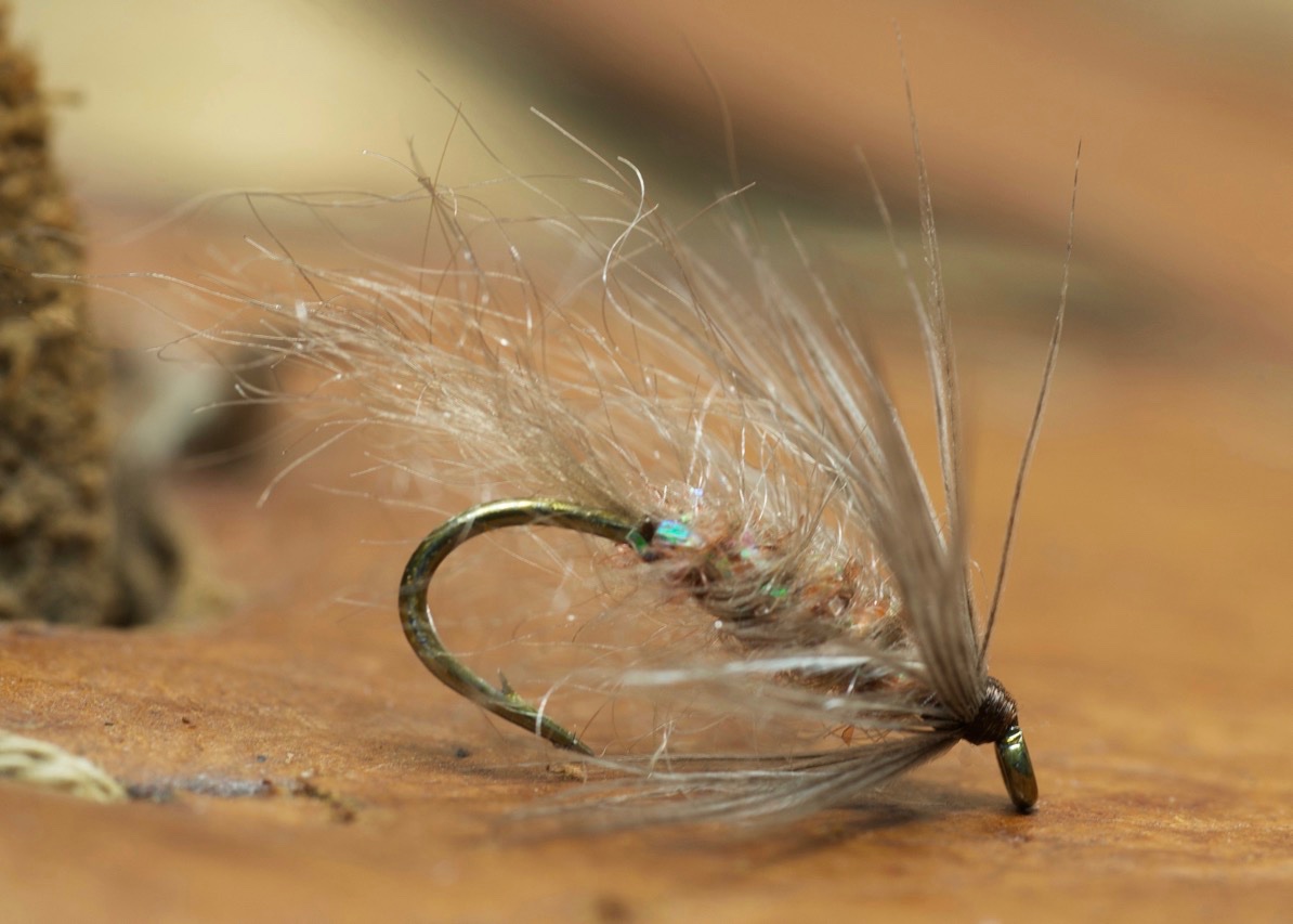

When I was in Bozeman area I came across an extra small crystal chenille by UTC that was sold on spools. Karsten (fly fisha) introduced me to fuzzle flies years ago and I have found them very productive especially the Fuzzle Tadpole and Fuzzle Bugger as well as my version of a Fuzzle Minnow. When I saw this small chenille I immediately thought fuzzle flymph. I bought a few colors and here we go. Basically, using a normal dubbing technique you add the dubbing directly to the chenille, spin, wrap and brush it out. It takes a little practice to get it right but a very simple process. I don't know what the official Fuzzle Dub material is but I have found that long fibered acrylic yarn is a great substitute.
Fuzzle Flymph
#14 TMC hook
Hackle: medium dun hen
Tail: small bunch brown dun Fuzzle Dub
Body: UTC small crystal chenille, rootbeer
Dubbing: brown dun Fuzzle Dub

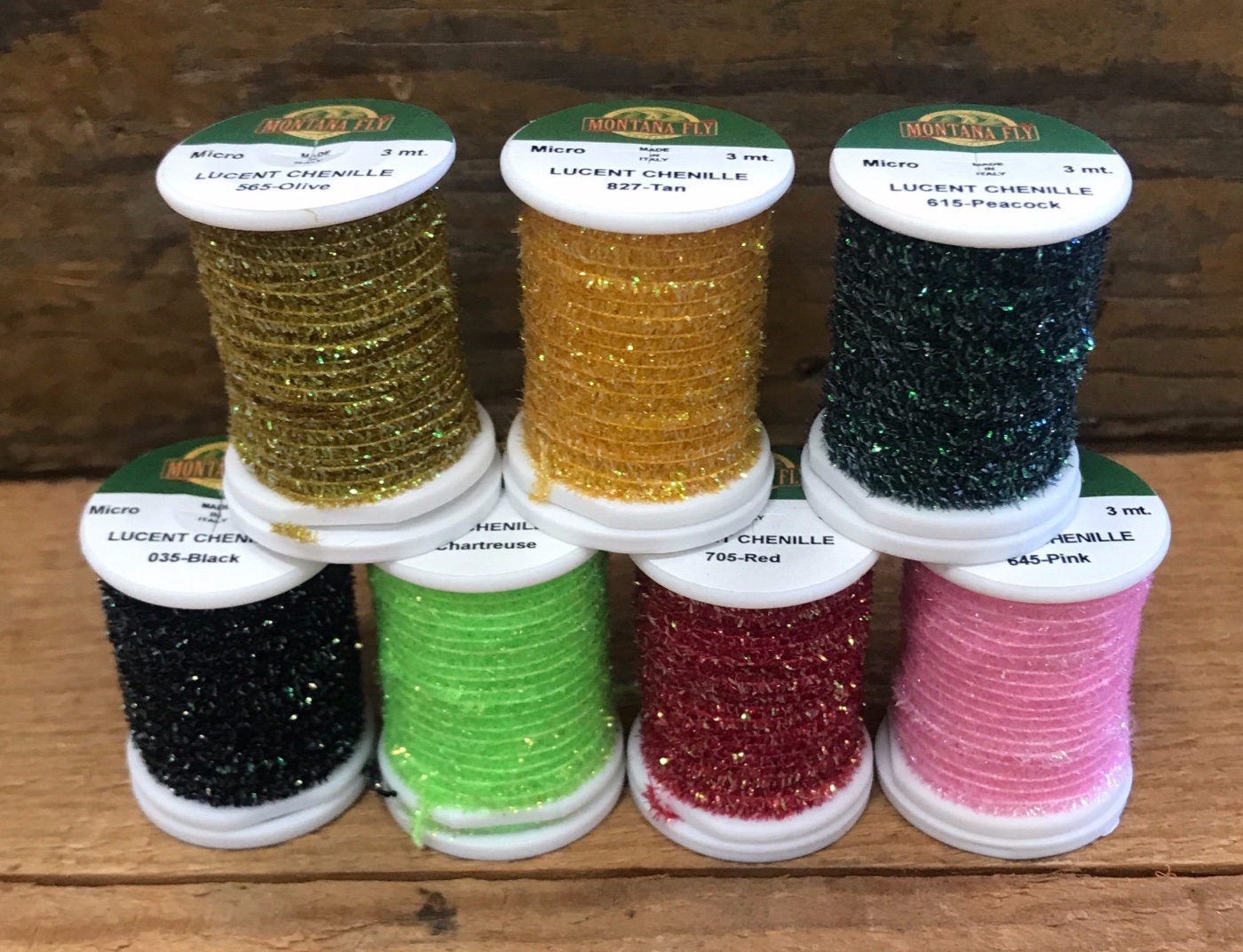

I found it under 2 different names. MFC has it as Micro Lucent Chenille and UTC has it as Micro Herl Chenille. Both are a crystal chenille about 2mm diameter. I found the MFC stuff at Galloup's Slide Inn and the UTC at Arrick's in W. Yellowstone. You just dub a good amount of dubbing right onto the chenille and brush it out.

Gorgeous tie as always Carl, Muz would be proud of that one :D

Post by Old Hat » Thu Aug 15, 2019 1:23 pm
This is the Wapsi (UTC) Herl Chenille in root beer that I used. I liked the Wapsi colors better. They seemed a bit more translucent.
This is the MFC Lucent Chenille
