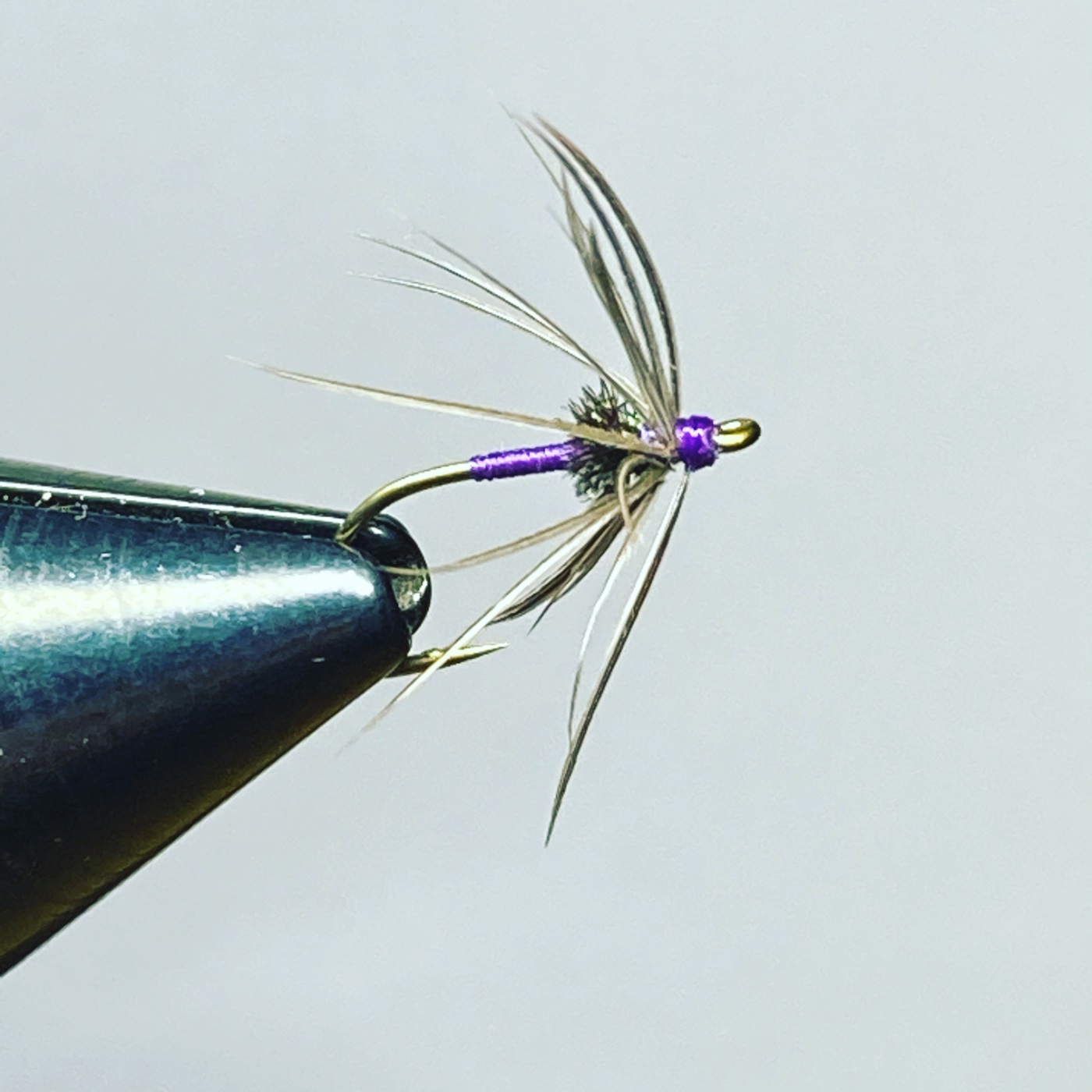

The fly is tied on a Kamasan B410 hook size 12 using Uni-thread 8/0 purple for the body. with a peacock herl thorax. The hackle is taken from a Mallard duck wing. I tie the fly in sizes 12/14/16.
Note - This fly was created in the 1950s by Harold Howarth a Lancashire fly tyer, who fished the Snipe & Purple but wanted a more robust hackle than the snipe. He also added the peacock herl to give more ‘kick’ to the hackle. The fly was tested on the Henthorne stretch of the River Ribble, hence the name.

Wonderful post. Lovely wee spider and background.
Thank you for including the dressing. I was guessing that the hackle was waterhen. I was pleasantly surprised to read mallard duck wing. (More easy to get)
Thank you for sharing this pattern, and I hope see more of your posts in the future. Welcome aboard!

Welcome to the forum! I too thought the hackle was waterhen, but I agree, the mallard is a more robust material.

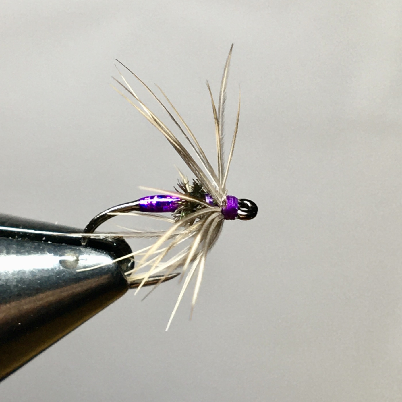

Here is a Snipe & Purple that has been meddled with?
Hends BL599 size 14 hook, Uni-thread 8/0 purple. Thread body over wrapped with holographic purple tinsel then treated with Deer Creek UV fine resin. Thorax of peacock herl. Snipe hackle.
I hope you like it. In my view the holographic effect really adds something.

Excellent ties, one hewing to tradition and one utilizing modern materials, both inspire. Each is very likely to find fish. Great work. Thank you for the informative post and great photos.

Would you mind posting the mallard feather details? Possibly a photo of the skin, showing the location where you plucked the feather. I too thought it was waterhen....
