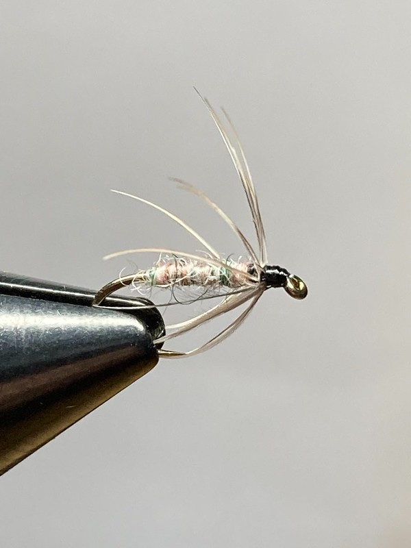

Here is a fly tied using Jamieson’s Shetland Spindrift wool, which has become quite popular in the fly tying community, especially since Chadwick 477 darning yarn, used in Frank Sawyer’s grayling bug, is no longer available.
I like tying with Jamieson’s Shetland Spindrift wool. It is very ‘buggy’ .

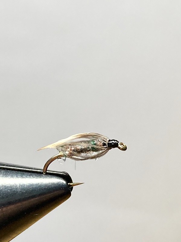

You can also see what it looks like wet.
Hook : Kamasan B405 size 14 (tied in 14/16)
Uni-thread 8/0 black.
One ply (strand) of Jamieson’s Shetland Spindrift Fog (272) wool tightly twisted for the body.
Starling hackle.
David

Stunning wee fly. I do appreciate the photo of the fly wet as well. The Jamieson's Spindrift yarn has quite a following here on the forum as well. I believe it was Ray (Letumgo) that first introduced it to us. Since then, several folks have purchased skeins of it in various colors and passed it around to other forum members. Love the multiple colors in each strand. As you say, quite buggy.
