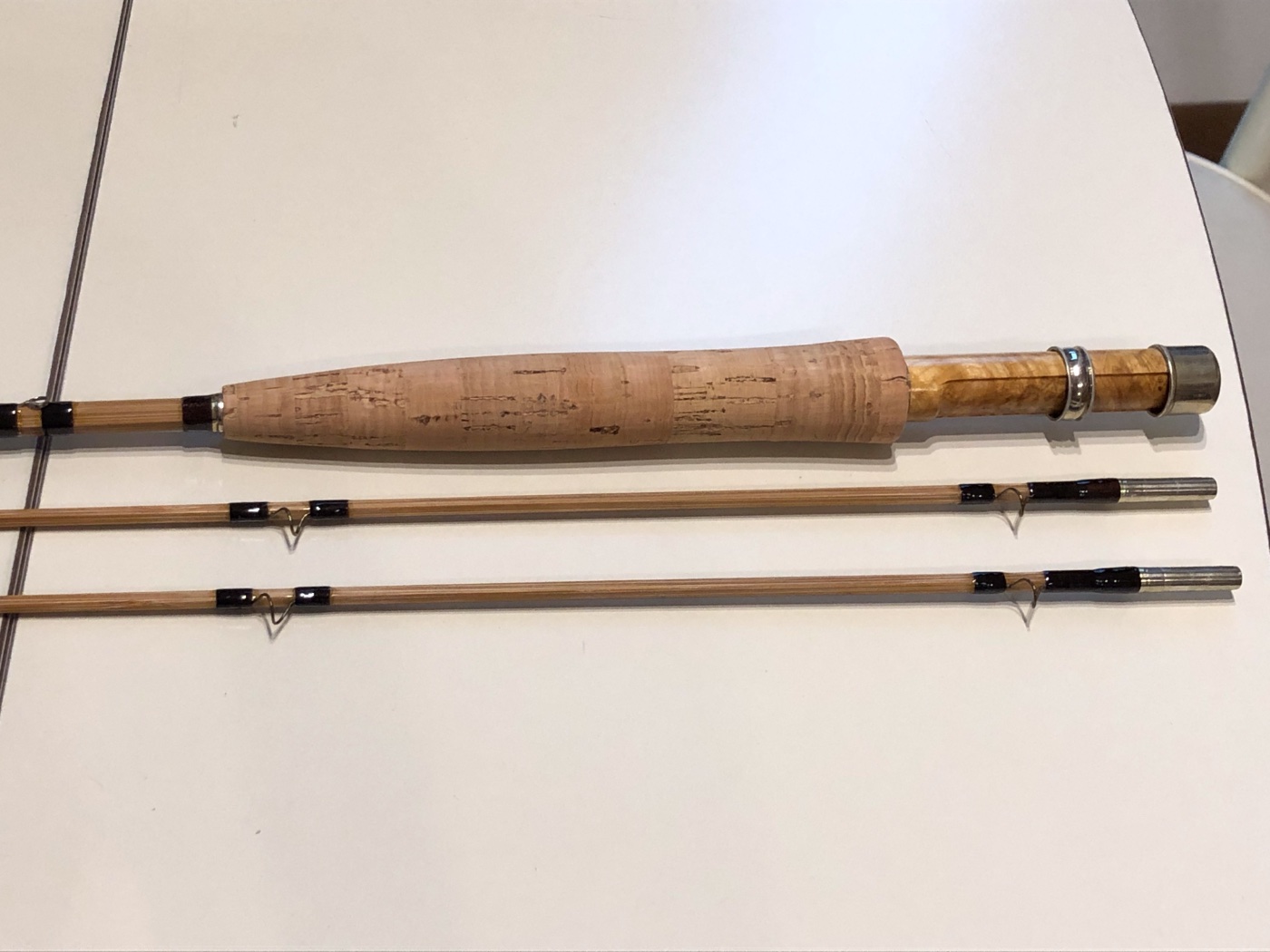

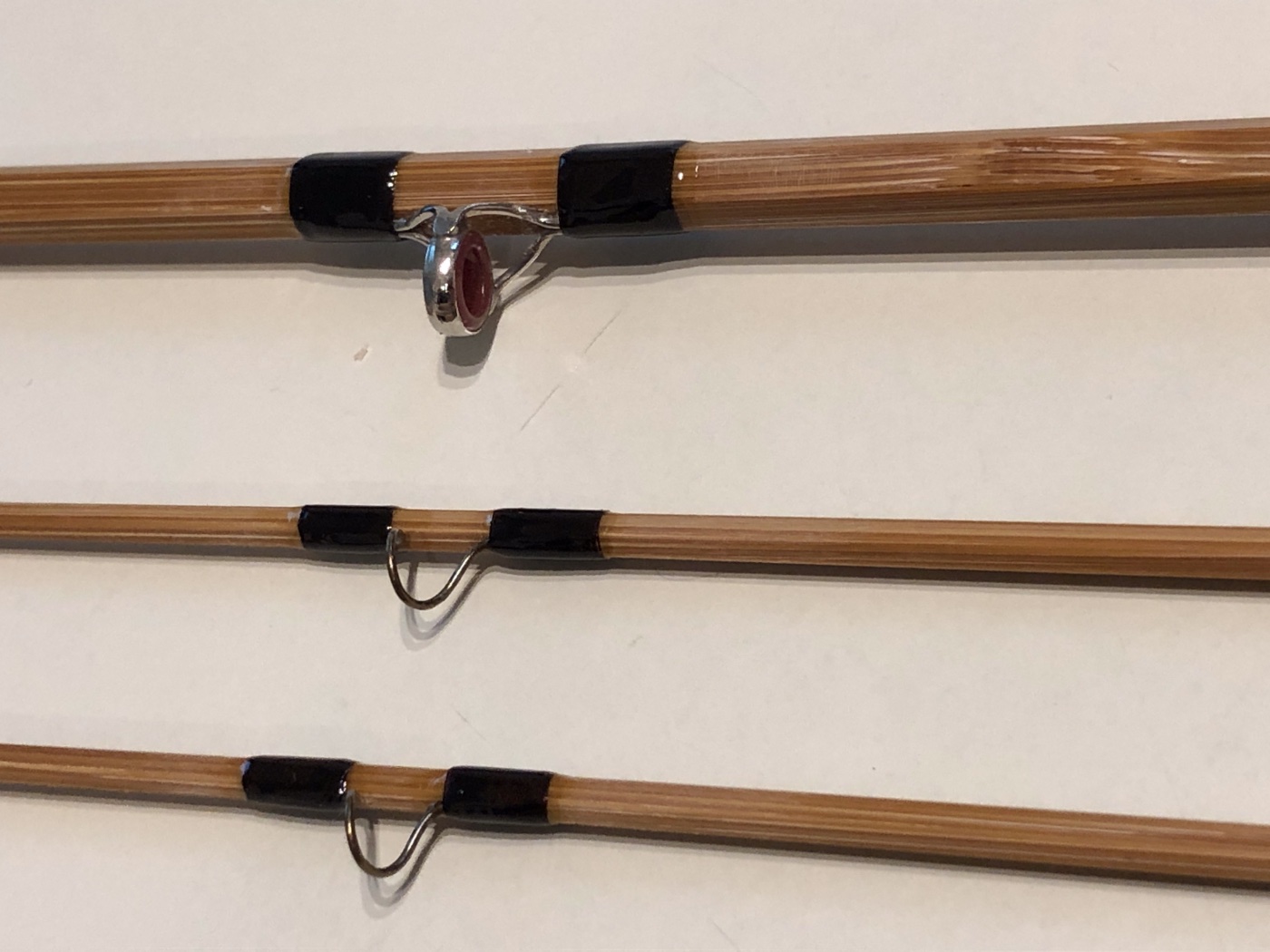

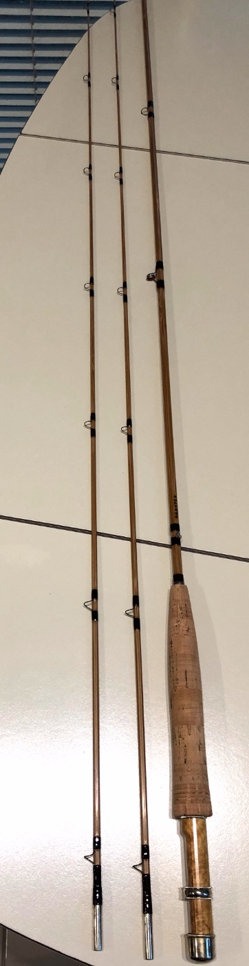

Post by joaniebo » Thu Aug 08, 2019 8:40 pm
Here's some pics of the 7 1/2' 2 piece, 2 tip 4/5 weight rod.
