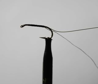

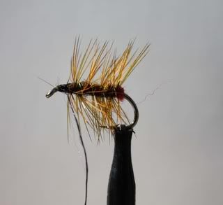

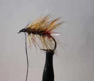

This is a patter i came up with a couple of years ago for Lough Melvin and Sheelin.
I found that by using claret for the legs it stook out more prominent on peaty coloured waters.
Here is the Recipe.
HOOK-NO 10 MED WT
THREAD-
BLACK OR BROWN 8/0
RIB-
CHATREUSSE UTC WIRE
BUTT -
RED DUBBING
BODY-
PICRIC DYED CHARLIE HAIR
BODY HACKLE -
PICRIC DYED FURNACE
WING-
PICRIC DYED COCK PHEASANT QUILL
LEGS-
CLARET DYED COCK PHEASANT
FRONT HACKLE-
PICRIC DYED FURNACE

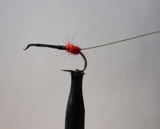

TIE IN THE UTC WIRE
TIE IN THE RED BUTT
TIE IN THE CHARLIE HAIR
WIND IN THE BODY HACKLE
NOW GET A VELCRO BRUSH AND BRUSH THE HACKLES BACK

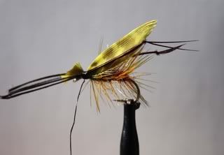

TIE IN THE WING
TIE IN THE LEGS EACH SIDE OF THE WING
FINISH OFF WITH THE FRONT HACKLE AND VARNISH
