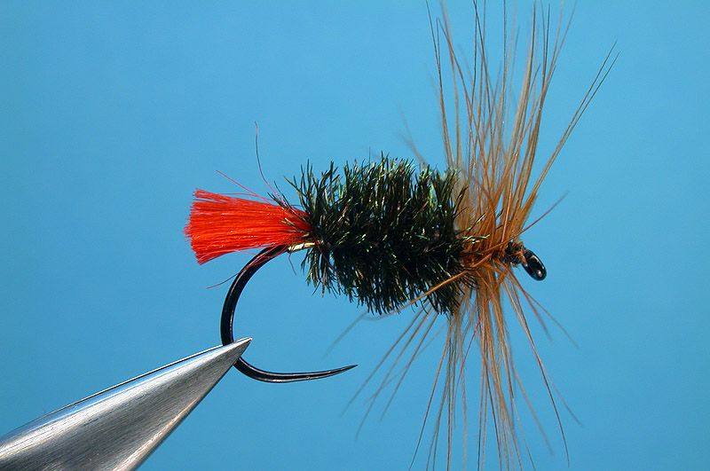

If you are right handed fly tier, then to get the very best full bodies (without twisting) - see this:
(which is there heels wrapped forward independently) then you need to take the heels from the left side of the peacock eye as it faces you.
You then place them onto the hook and wind forward in a 'clockwise' manner.
If you are left handed, then you would select them from the right side of the feather.
Now the interesting thing happened when you are tying 'ts of flies as a right handed tier and you are leaving all of those heels on the right handed side.
Well, you simply wind them down the hook shank in a 'anti-clockwise' manner.
You will get the same effect.
