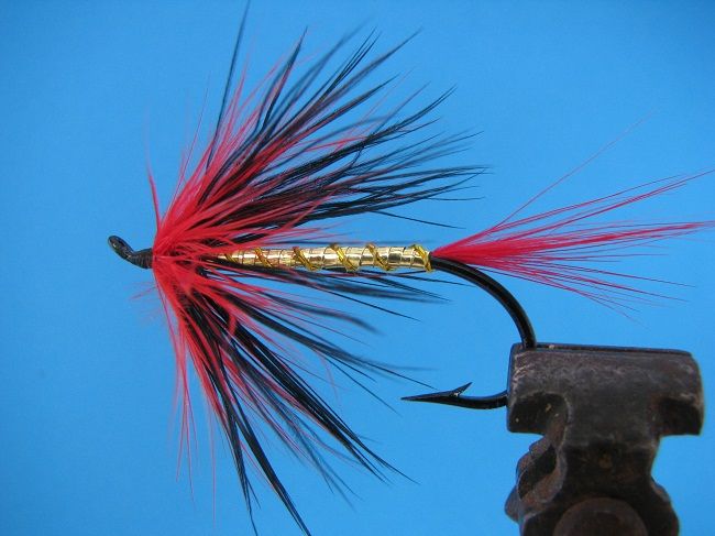

Found reference to these two patterns as being useful for Sea-run trout by the Danes. We do not have true Sea Trout here, the introduction failed (maybe they hit the sea and swam home to the British streams? :lol: ), but they might be of interest for some of you to try.
This is my favourite..... for name alone!
Idioten (Idiot)
Hook: #1 up eye Salmon iron
Thread: Black
Tail: Red hackle fibres
Tag: Oval gold tinsel
Body: Flat Gold Tinsel
Hackle: Soft black with soft red over.
Head: Black

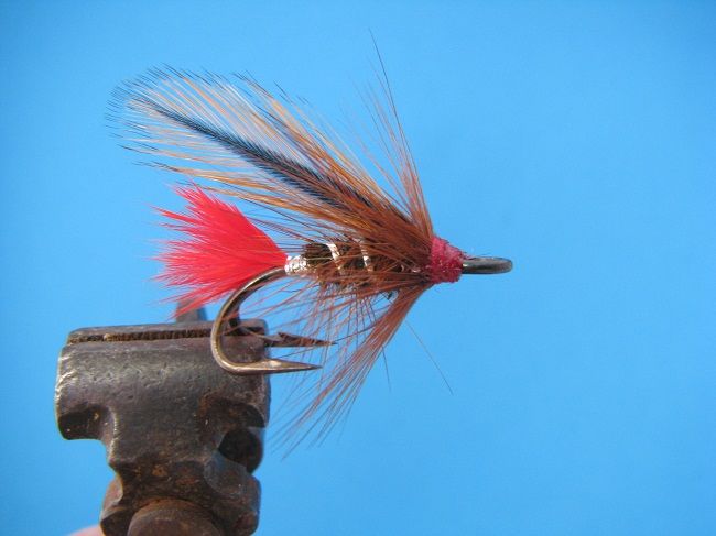

Hedefluen (Moor Fly) WARNING...... WINGS!! :D
Hook: #2 Double *
Thread: Black for main body, red for head.
Tag: Narrow flat silver tinsel
Body hackle: Chestnut brown cock hackle
Body: Peacock herl, tied plump and full (8-10 strands)
Wing: Two furnace hackle, back to back
Front hackle: Brown hen.
* This example is NOT tied on a #2 double as I do not have a double hook to my name! What I did was sweat the third barb off a treble #6, squeeze the two remaining barbs toward each other a bit and use that. So it may appear a bit squat rather than the true big Sea-Run fly it is meant to be. :D

lykos33 wrote:LOVE the flies...slapping myself for not thinking of your method of creating a "double". The price of quality doubles is c-r-a-z-y! I can now cheat a little and at least have some smaller doubles from trebles...thanks for the inspiration
Murray
Murray, that was born of desperation and perhaps not the ideal. If you are going to try it might be easier or safer to cut the bend off the third hook with a Dremel or similar, or snip it off with good sharp wire cutters and file the stub left.
Heating enough to melt the brazing holding the third shank may alter the temper of the other two. I used a propane torch on very low heat and jammed a blade screwdriver under the shank bend of the one I was removing, levering off the bend of the other two with a lot of force, so it kind of tore the third shank out when the braze was soft, not fall off when the braze was melted.
Some European tiers tie on trebles, you could always try that? ;)
