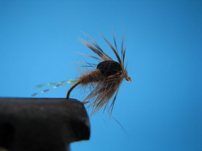

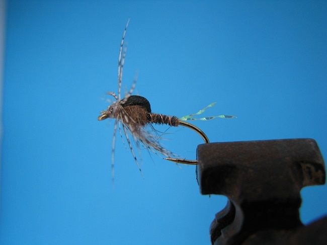

Last couple of seasons I have been using a heavy beaded nymph as the top fly and a Pogo nymph as the point.
How do you make a Pogo better?........... Add a soft hackle!
Hook: #14 1XL of choice
Thread: #12 to suit body colouration
Tail: 2 strands of krystal flash
Rib: Fine copper wire
Abdomen: Golden Pheasant tail fibres
Wingcase: 3-5mm Black Foam
Thorax: Brown Aussie possum with good guard hairs
Hackle: Partridge
Hook: #16 2XL slightly humped of choice
Thread: As above
Tail: As above
Abdomen: Brown possum underfur
Wingcase: As above
Thorax: As above
Hackle: Mottled Brown Hen
The whole idea of the Pongo is it bounces along the bottom, trying to rise (thanks to the foam wingcase), but it is held down by the front weighted nymph. A lot of Mayfly naturals glide along with the current before rising to the surface to emerge. The larger wingcase can give the illusion of wing buds about to burst forth.
